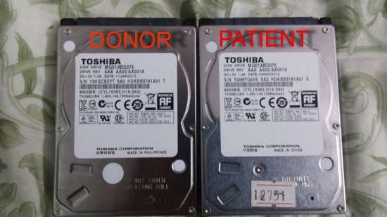

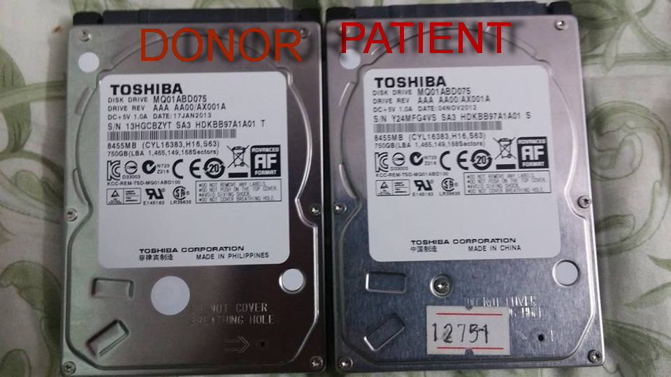

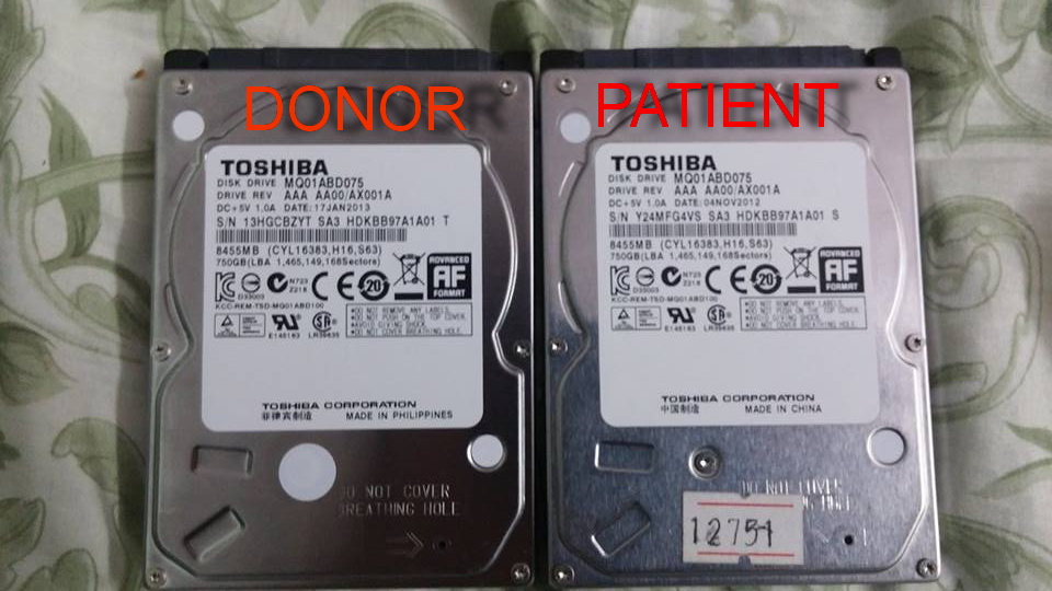

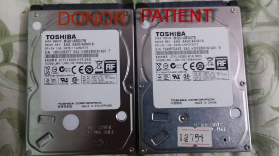

I have a Toshiba 750GB MQ01ABD075 hard disk that clicking and needs head replacement
How could I choose the donor one?
I uploaded the picture of the patient hard disk and I have another one that is similar to it and I want to ask if it is suitable to transfer the heads from it to the patient one? if it is not which one is suitable?
Please help me from where can I found the suitable one and what is the best donors websites which prices is good?
Please answer me quickly
Thanks a lot
Most likely heads will fit, but this probability isn't 100% perfect - once we've had one, where everything except the S/N was the same, but heads didn't match.
But be prepared to a concentric scratch. If the drive is clicking and unable to id, then I'd say that probability of scratch is 95-98%. If it identifies, but one head isn't reading, then chances are lower, but still high.
The exclusions are drives, where heads got stuck and died because of that or just turned inside out / smashed.
