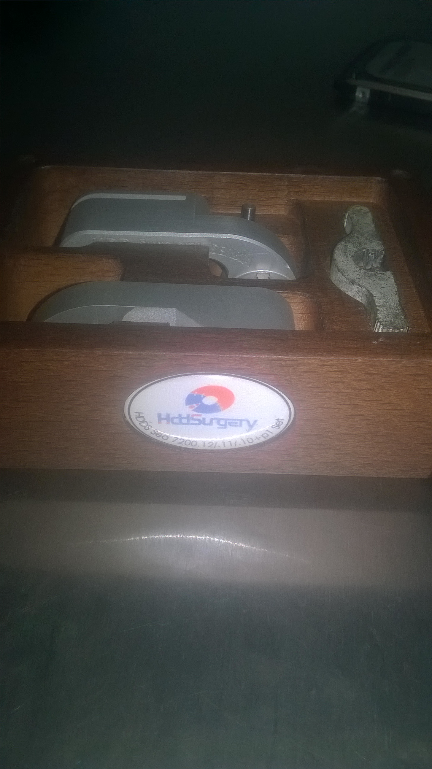

Recently I have purchased Hdds sea 7200.12/.11+p1 set from HDD Surgery. I have tried more than 15 hard disk with same model donor nothing successful. the tool is fine working
I have a clean Room too also I am very successfully replacing Heads for other brand (WD, Toshiba, Samsung) . I am clueless .

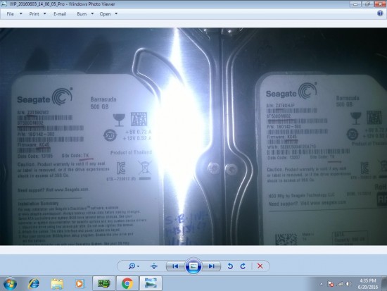

Hello sorry ALL

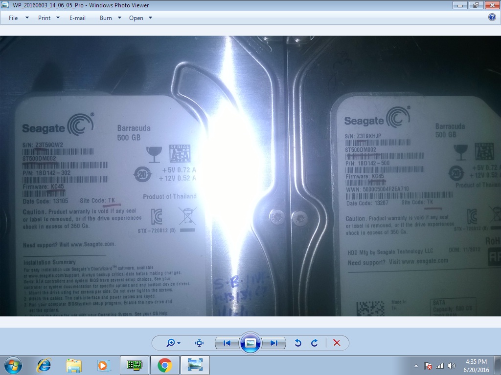

I am not blaming the tool, this is the best tool ever made. I have tested the tool with the working hard disk it is fine. only my problem is when I replace the head with head damaged hard disk same model, Firmware, Site code it is giving clicking sound. I don,t know the mistake.
Kindly help me. If any one have technical details kindly send me
my id is ssemmalar@gmail.com

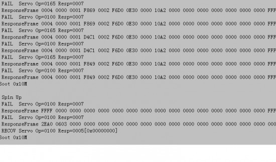

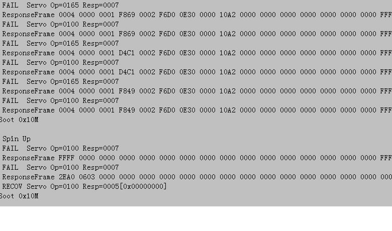

Can you paste terminal output?

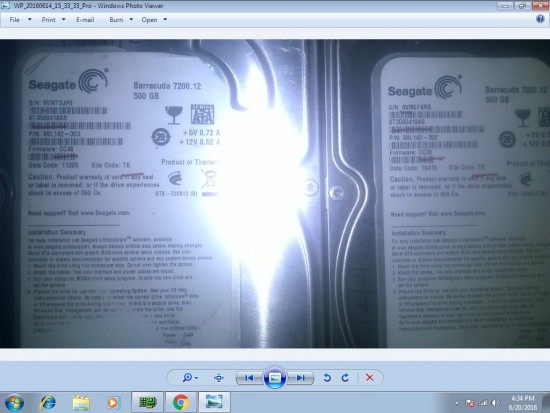

Hello Help Disc,
I Have attached the terminal and images of some case I Have tried and failed. How important is date code in Seagate HDD.
Kindly suggest.

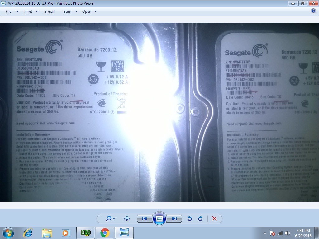

Case 1
Patient Drive Donor Drive
9VMEFKR5 9VMT5JP0
ST3500418AS ST3500418AS
CC46 CC38
Date 11205 10415
Case 2
Z3T9XHJP Z3T59QW2
ST500DM002 ST500DM002
KC45 KC45
DATE 13207 13105
Is it matching. kindly help
 Post subject: Re: Seagate Hard Disk Head replacement Matching
PostPosted: June 14th, 2016, 11:11
Case 1, not a match. The date is 7 months or so off.
Case 2, might work but needs more details such as P/N to be sure. However given that it's a DM series, are you sure you've even properly diagnosed it? There's a lot of these getting misdiagnosed as head failures when it's really other issues at the root of it.

Hello Data-Medics
Thanks for your valuable reply. I have diagnosed properly and concluded the head fault,(what other problem could be) How close the date need to match.
Case 2
Patient Donor
Z3T9XHJP Z3T59QW2
KC45 KC45
DATE 13207 13105
1BD142-500 1BD142-302
Kindly suggest
PostPosted: June 15th, 2016, 4:50
Posts: 3551

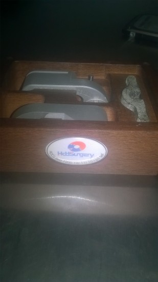

Is that corrosion on your hddsurgery tool?
Douglas Crowell wrote:
Hello Data-Medics
Case 2
Patient Donor
Z3T9XHJP Z3T59QW2
KC45 KC45
DATE 13207 13105
Kindly suggest
This is a good match.

Hello Northwind.
No Corrosion on the tool .

PostPosted: June 15th, 2016, 13:14
Posts: 709
Location: Belgrade
You post problem on wrong place, you should be looking at pc3k of general forum.
There is a lot of things in DR then just head change.
Seems you changed them good, but other things other should explain.
I would start from adpatives head map etc etc...but this is whole another part of DR
