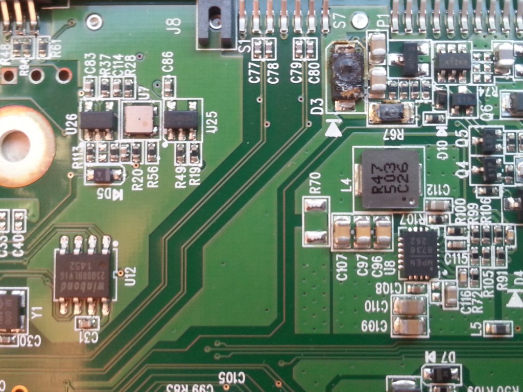

I have disassembled the PCB from the HD.
I have seen that the electronic component that fired up is the D3 diode.
I think the U12 IC isn't broken and if I'll replace the U12 of the new PCB with this U12 the HD will work, am I right? :?:
If the HD won't work I can try to replace the diode. :D :!:
File comment: Picture of D3 and U12

Actually, you can just remove that diode and it might work. I wouldn't trust it for long, as it'll be susceptible to power surge, but it'll probably work long enough to copy the data out once as long as your power supply is good.

v27 wrote:
The motor of the HD still spin, but it isn't recognized by the pc.
It appears that D3 is shorted and R67 is open. This often (usually?) means that the preamp (inside the HDA) is dead.
This is what usually happens:
Catastrophic failures in Western Digital PCBs:
http://www.hddoracle.com/viewtopic.php?f=59&t=1119
Good luck with U12, but I expect it will be a lost cause. :-(
