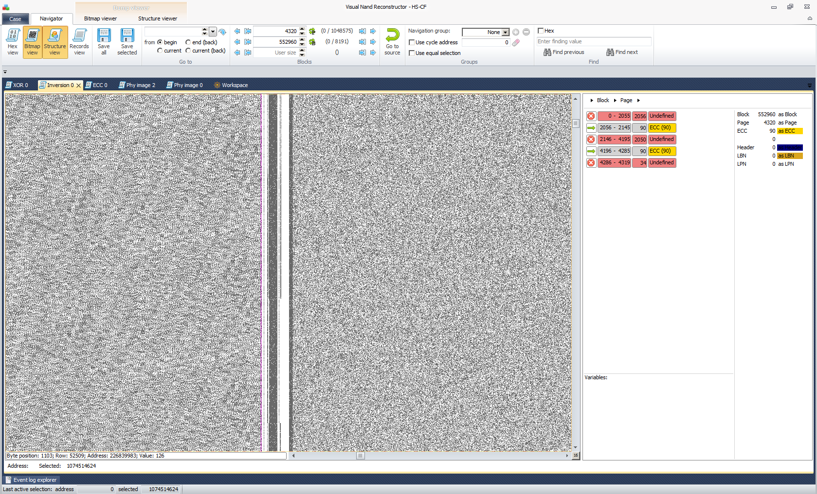

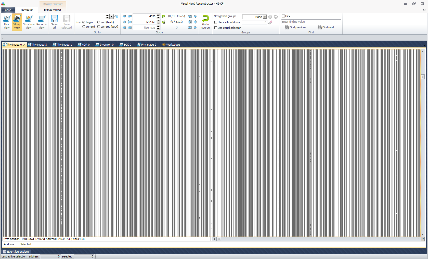

For the sake of learning, I ripped open a 16GB CF-card which has 4x FT32G08UCT1-B7 and Phison PS3016-P9 on it. When trying to read the ID of the chips I got basically "00000000" or "2121212121" or similiar. There's no exact match for the chip in the db but FT32G08UCM1-15 seems to be closest so I used that one. Dumped all four chips without any problem.
However, I do run into problems when I check the dumps in bitmap viewer. Image 0 looks like this:
Image 2 looks like this:
Is Image 0 a dead chip, or has there been some error during the dump?
Image 2 shows a lot of bit-errors in the SA. Is that because of a bad dump?
(VNR 2.4)

Hi ,
Please Post Post Photos Of Device And NAND Flash ,You Need To Update Version Of VNR to 3.9 ,Speak To Katarina Please .You Said 4 Chips Or 2 Chips ? . Are There 2 Parts Per Each 4x Chips or 4x Parts Per 2x Chips .
PS : Its Very Interesting To See This Controller ,I Have Always Seen SM2236 Under Its Own Name Or Sandisk Name

It's four physical chips, all marked FT32G08UCT1-B7.
And I cannot upgrade to VNR 3.x, I'm kind of stuck with 2.4.

Google suggests that these are remarked by Kingston. The 64Gbit versions are claimed by some to be Toshiba chips.
https://www.insidegadgets.com/2013/07/02/inside-the-kingston-60gb-ssdnow/
https://proclockers.com/review/kingston-ssdnow-v300-128gb-solid-state-drive-review/
