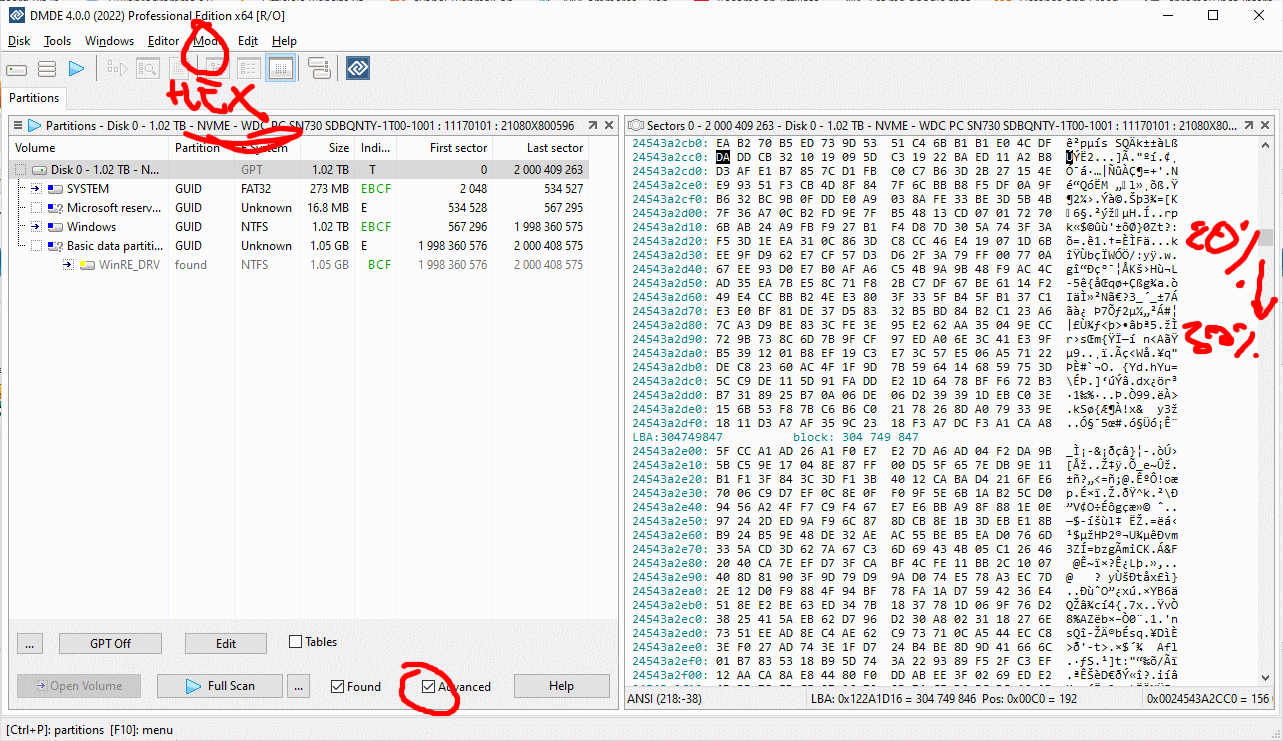

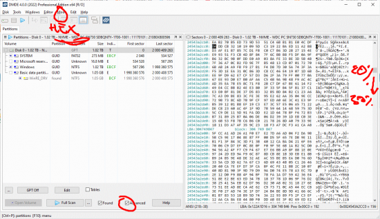

Is it trimmed/zeroed then? Did you check this first?
For example, DMDE in partition TAB click 'advanced'. In hex view what does it look like 20% or so into drive? And 30, 40%. If you see 'random' data you can just try a file recovery tool.
