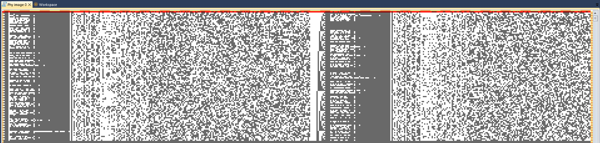

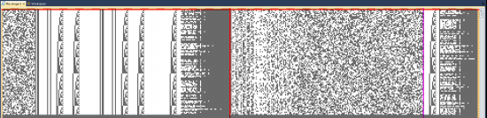

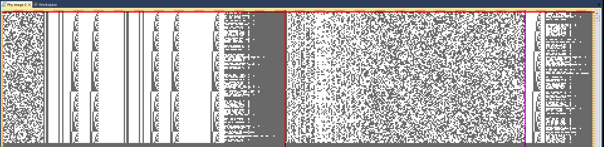

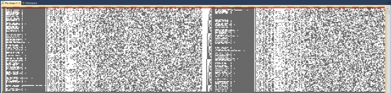

I am often asked to pull data from an assortment of different devices other than flash drives or SSDs.
Recently I came across a device I needed to pull data from which has a small Adesto 16Mbit SPI flash. I successfully read the entire contents of the NAND flash (as I have many other times with similar devices), but I notices something peculiar about the flash contents, and thinking, well, it is NAND, decided to take a look at it in VNR to see the structure needed to be fixed.
I've attached an image showing the structure in bitmap form. According to datasheet, page size is 528, each block is 4224 bytes.
Data area seems to be broken into 28 byte chunks followed by the SA containing LBN and ECC. The weird part comes in where the first 4 bytes appears to be a Data Area, followed by some SA, but those 4 Data area bytes seem like they should have been the END of the data area found at the end of the page (the last Data Area on the page is only 24 bytes and appears to line up in pattern to those first 4 bytes I mentioned).
What I'd like to try to do is take those first 4 bytes from each page and append them to the end of the last data area. Logically that makes sense to me, but I just don't know how to execute this plan in VNR.
Anyone have any ideas?

ALSO! Just realizing this that I forgot to mention, the first screenshot is of the end of the pages, and the second image is the beginning. You can see how those first 4 bytes of each page appear to be data followed by SA, and the end of the page is what I am assuming to be the preceding data of those 4 bytes.
