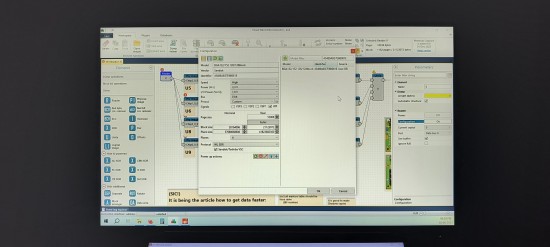

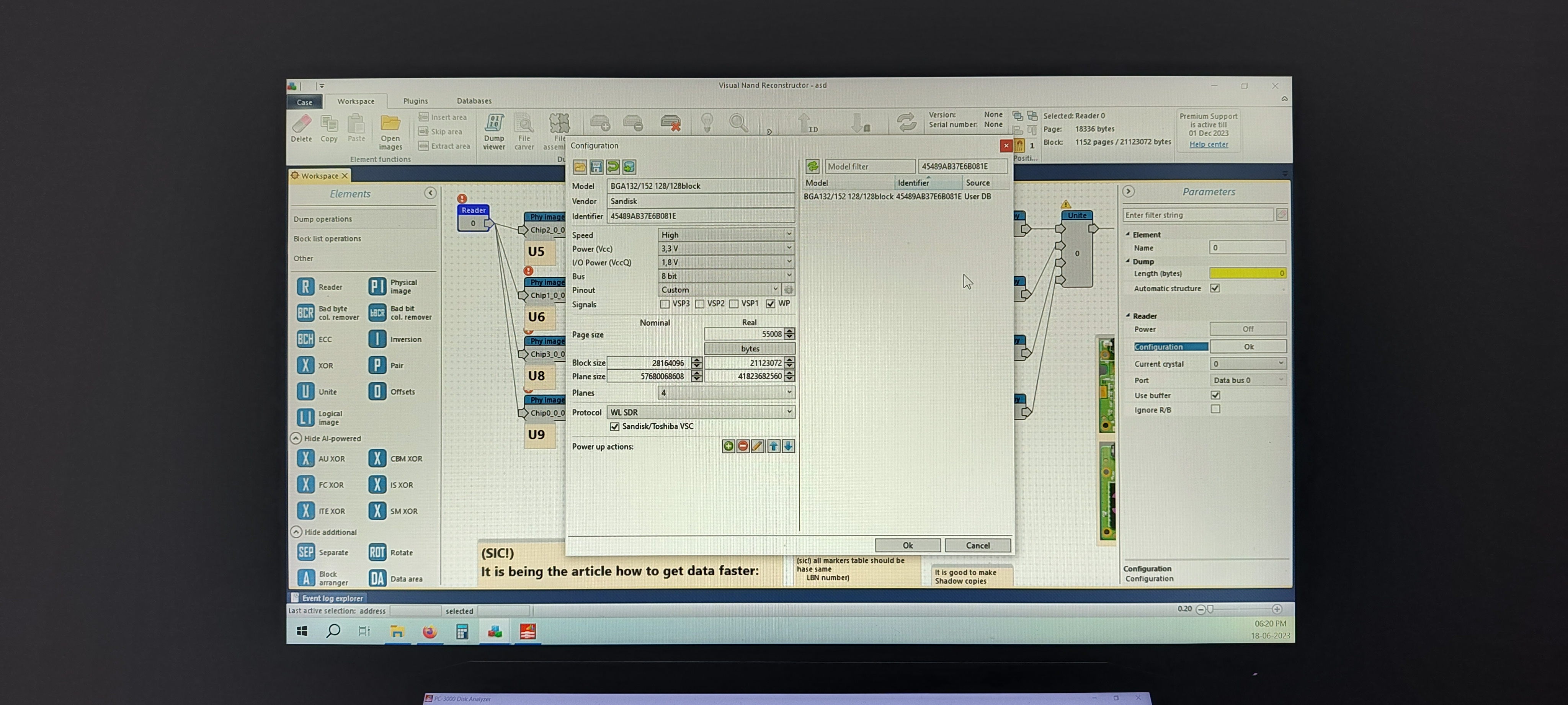

 Post subject: Re: WD Green Sandisk 20-80-00496-2 With 4 BGA 132 [New NAND
PostPosted: June 18th, 2023, 12:15
Guys ,
This Was the Config ....
