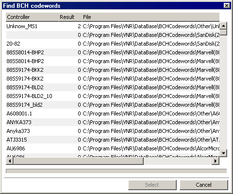

Sasha Sheremetov wrote:
Are we still talking about this tablet's dump?
If so, I tested BCH and it was green.
Yes.
The thing is, when I clicked the yellow lamp in BCH elements, I only found 2 matches in one codeword, while in your case you have a lot of codewords. That's why I was asking "May I ask what kind of magic do you use in the BCH code words, and how were these found out?" earlier, because I couldn't figure out how or even what you did in that step.
Here's when I click the bulb:
Here's your codewords:
 Post subject: Re: Unable to find Spare Area for Micron FT32G08UCM1-15
PostPosted: October 18th, 2017, 18:24
Joined: July 2nd, 2014, 8:05
Posts: 215
Ah I got it.
The BCH element works very flexible (yeah, unlike in other tools!) so you have two modes - manual and automatic.
I made completely new BCH code for your device manually so you have it in BCH element as a formula.
Now if you save a code as file and place it into BCHcodewords folder autodetection will find it (most likely) when you run it next time.
There's a button in BCH codewords editor - save/load.
