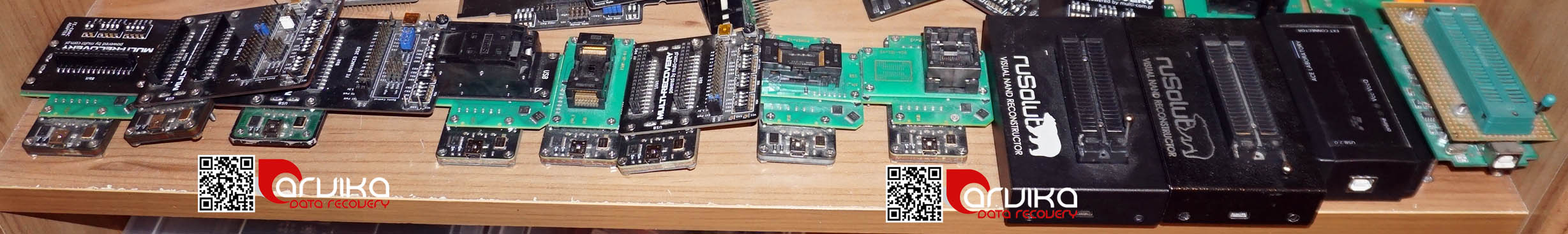

Amarbir[CDR-Labs] wrote:
Well,
We Can Have Another Computer and Do Tasks which do not use the reader ,But if you have to RR then you need to have two VNR's or a VNR and FE Or Similar Tool .How Good is FE RR for these Chips ? .
Readers are not a problem. Time is the problem. When you have one case you can play many days, even weeks. Several cases with 1-2 week work per one case can disturb the work at lab.
