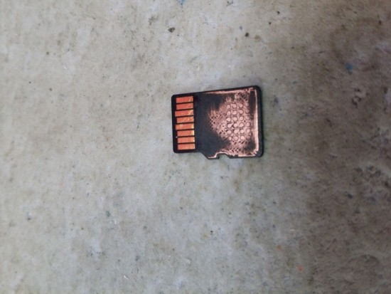

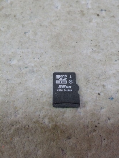

 Post subject: Pinout Micro Sd
PostPosted: January 5th, 2017, 11:49
Joined: December 5th, 2011, 10:24
Location: Spain
Hi
need pinout acces data micro sd for rusolut
send JPG
unspecified.jpg [ 194.97 KiB | Viewed 13610 times ]
unspecified2.jpg [ 180.67 KiB | Viewed 13610 times ]
 Post subject: Re: Pinout Micro Sd
PostPosted: January 5th, 2017, 13:06
Joined: July 2nd, 2014, 8:05
Posts: 215
Hi there,
This one is standard 6x4 pad pinout available in built-in database of VNR.
Open Devices db, choose type - monoUFD it's first pinout. The PCB may look slightly different but pinout is same.
 Post subject: Re: Pinout Micro Sd
PostPosted: January 5th, 2017, 20:38
Joined: December 5th, 2011, 10:24
Location: Spain
ok THK
Team
 Post subject: Re: Pinout Micro Sd
PostPosted: January 6th, 2017, 12:44
Sasha Sheremetov wrote:
Hi there,
This one is standard 6x4 pad pinout available in built-in database of VNR.
Open Devices db, choose type - monoUFD it's first pinout. The PCB may look slightly different but pinout is same.
Sasha ,
How are you feeling :) BTW reached 10% of the amount goal in 5 days for my rusolut :lol:
