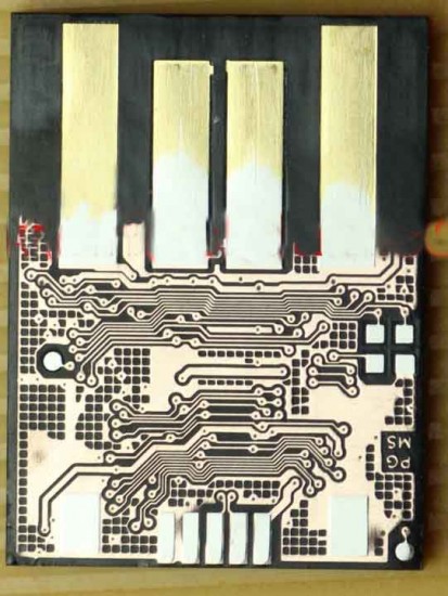

i am looking for pinout of kingston 16 gb pen drive. chip marking is 2324577-035 A01LF. does Rusolut support this models

Not yet, but you can send a donor device (or patient without returning back) and we can reverse engineer pinout.
