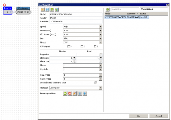

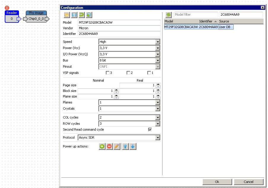

I just received my VNR today and I'm toying around with a scrapped NAND from an Android-tablet.
First: a tool this costly doesn't even have any help pages, not even a reference manual, nothing. That was quite a disappointment.
Second: I'm following the tutorial on http://rusolut.com/direct-access-to-nan ... xtraction/ but I can't even manage to pass the configuration step. Read ID gives me 2C68044AA9, but when I click "Configuration" I get zero hits (while the tutorial shows a match in the Trusted DB).
Removing 2C68044AA9 from "Model filter", and entering "Micron" as vendor still yields zero results. This somehow makes me think that the database for the chip-ID:s is non-existant, even while I copied the whole Database/ folder from the pen drive.
Then I accidentally clicked "Save in User DB", and then my NAND shows up in the list. And I can't even remove it. And since there's no online-help in the program, I have no idea how to remove it.
But still, the Reader object has this red exclamation mark on it, saying "Memory IC configuration contains errors", and I'm stuck.
And no, at this time I cannot afford the training programme that Rusolut offers.
Help?

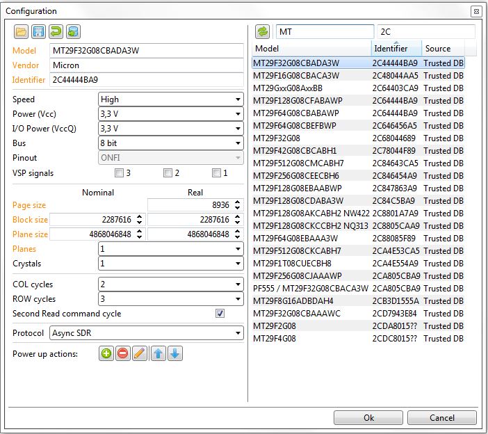

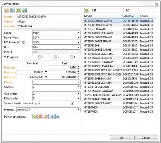

Erase the chip ID in the search box and then type the Model MT29 in the Model filter. Sometimes you will find something close entering part of the model number. The DB is quite limited so you should probably contact support. They will help via email or request to connect remotely and help you. You might want to verify the DB is installed properly by typing just 1 or 2 characters to verify there is data.

In the Case->DB menu, the two "Trusted DB" checkboxes were not checked. Checking them both made the model search work, just like your screenshot. So, now I finally managed to grab a physical dump.
