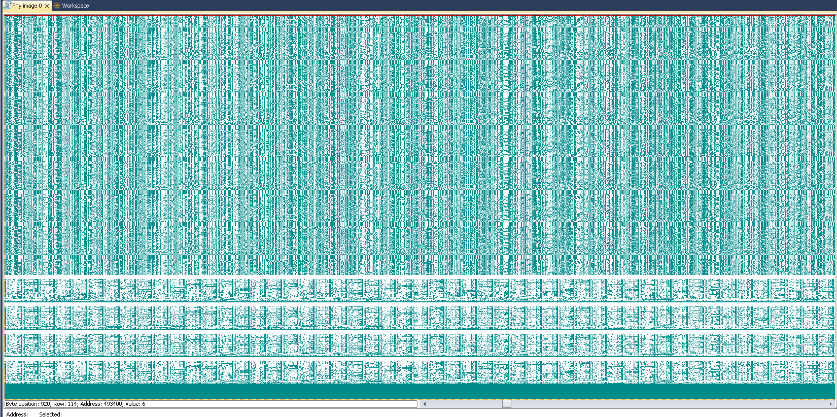

Hi

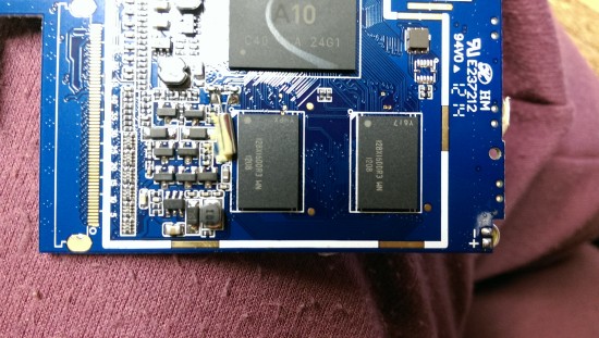

I'm toying around with this TSOP48-chip salvaged from my daughter's dead Android-tablet, just for the sake of practising. I've been following all documentation I can find, all videos I can find, and I think I've got a grasp of what to look for when describing the internal structure.
However, this particular chip seems like a dead-end for me, and I'm thinking it might be broken.

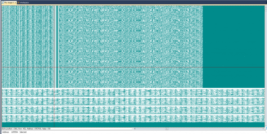

See image 1:

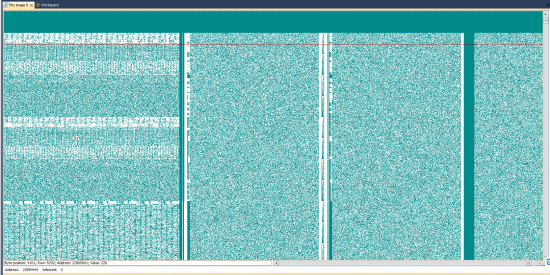

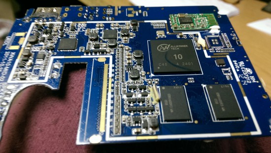

There's a lot of patterns and the variations look good. I'm scrolling rightwards to find the vertical lines, presumably the SA. I find it at offset 1024:

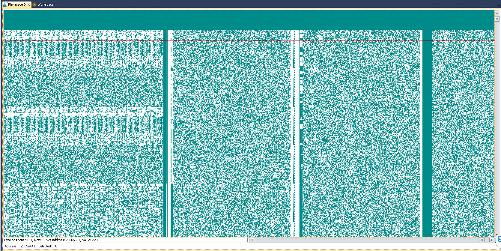

However, the lines are plain straight, no variation at all. According to the docs, atleast LNB should be variant since it's not the same for all pages. So, something is fishy here.

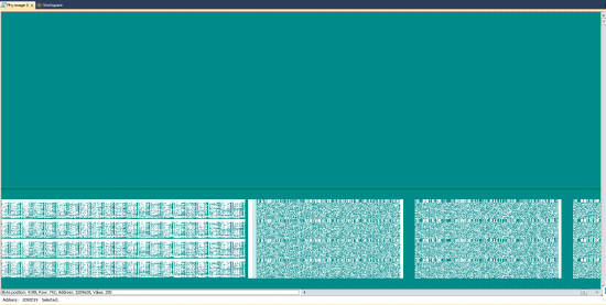

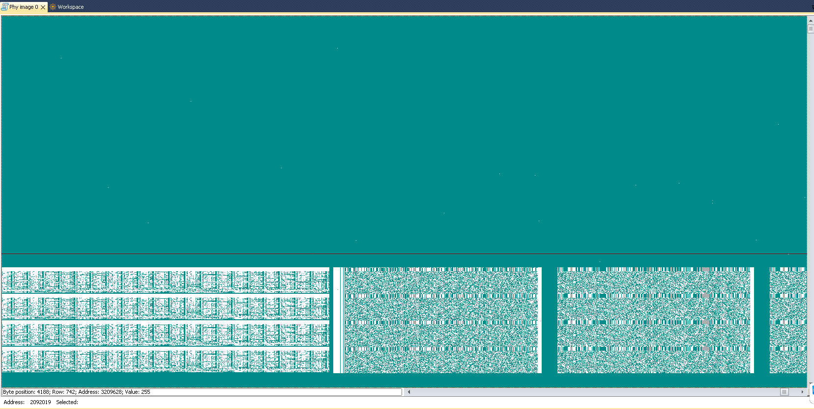

Also, from offset 1161 and all the way to the end (4319) there's no data at all; plain gray:
I've retried dumping the chip in full two times, but the gray area appears everytime.
So, questions:
1. Am I searching for the SA at the wrong place?
2. Is the chip partially dead?

Firmware chips usually are a bit different than NAND Flash used for storage as in a Flash Drive. The filesystem could be quite different, the chip itself might keep track of what part of the NAND to access such as the OS routines, programs and different storage areas / partitions etc. you might find part of the dump holds a FAT filesystem say for storing pictures (think DCIM) or it may use a Linux filesystem.
It looks like your chip was dumped correctly, and also it looks like it was a very good dump. Looking down the vertical lines in the second picture there are no random bits showing that would mean bit errors. If you open the dump in a hex editor, do you see any ascii strings? Most firmware chips will have areas where files are stored one after the other making up the underlying OS.
To be clearer, I don't suspect you will be able to put the dump back to a disk image of FAT... and this is the goal when parsing LBN, LPN etc.

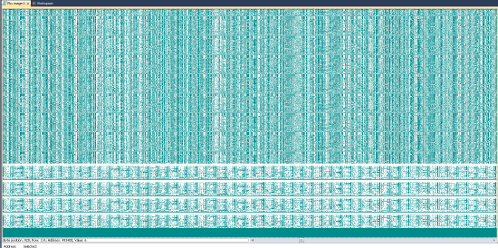

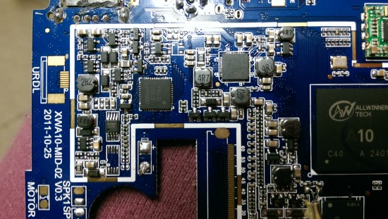

It seems you are correct. When I did a search for string "FAT" and "Android", the cursor landed in the area below my previous dumps. And if I scroll this area very far to the right, I find this:
And there are those vertical areas I was looking for earlier. Interesting.
You say "firmware chips". Does this mean a flash like this one contains a mix of non-filesystem data and filesystem-data in the very same chip? While the other ones are pure filesystem-chips?

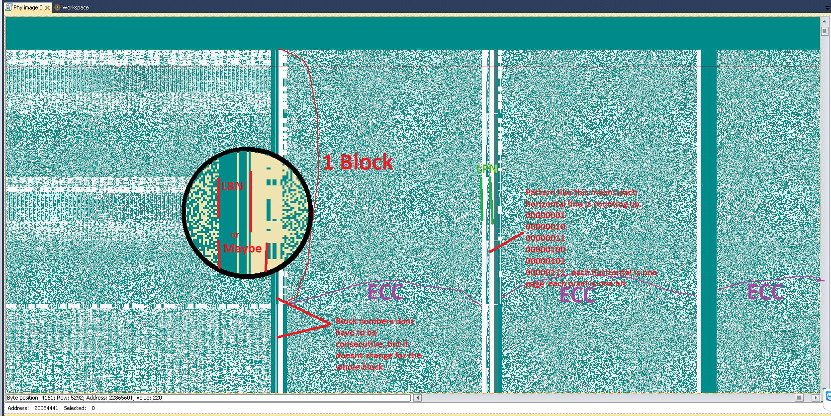

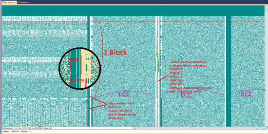

As I see page structure (geometry) is like this: data area 4x1024 bytes + 4x(SA with ECC), SA have 4 bytes probably, ECC you need check. It could be also Data area 8x512, it is easy to check. If SA/ECC part has 4 repeat DA is 1024, if 8 - 512. We can also see LBN at first SA part, and LPN in second.

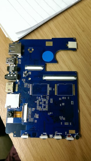

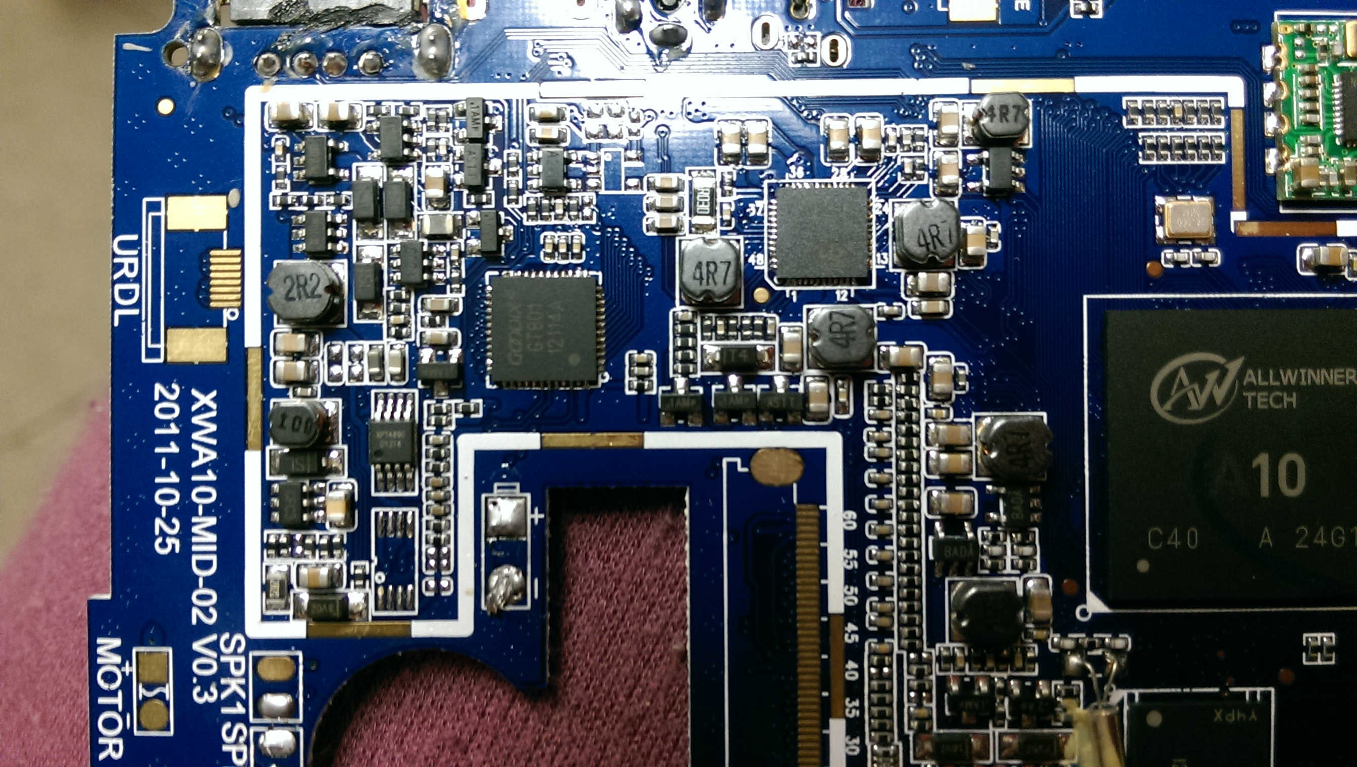

Please attach high-res pictures of PCB from both sides, need to know controller model too.

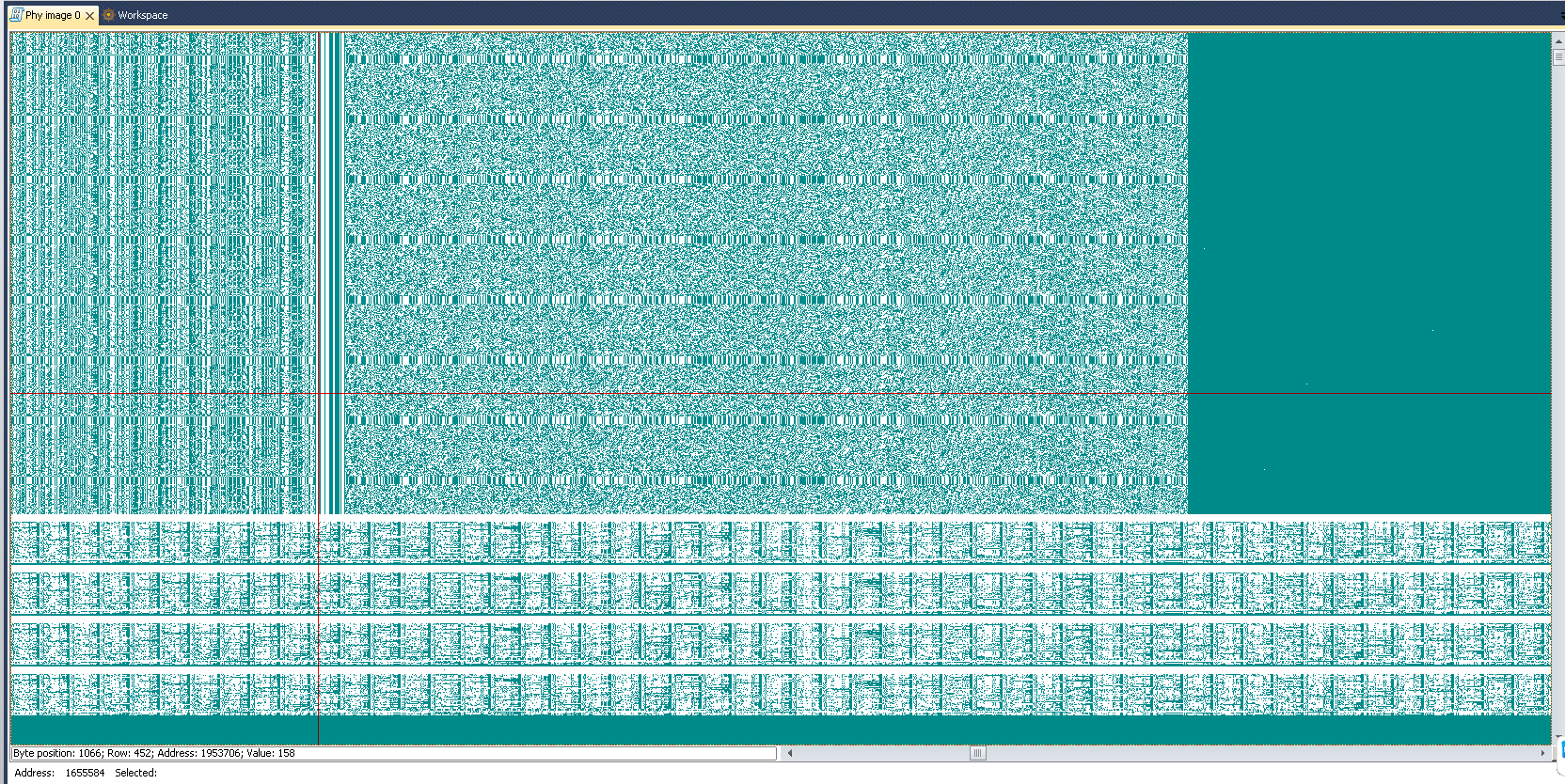

This is roughly how I see it. Yes depends on the device, but many IOT devices will have firmware on nand chips, some will have emmc chips with different partitions, some will have both. If there is only one processor chip that is not a MCP, but proper CPU and one memory chip it is probably all on the one chip.

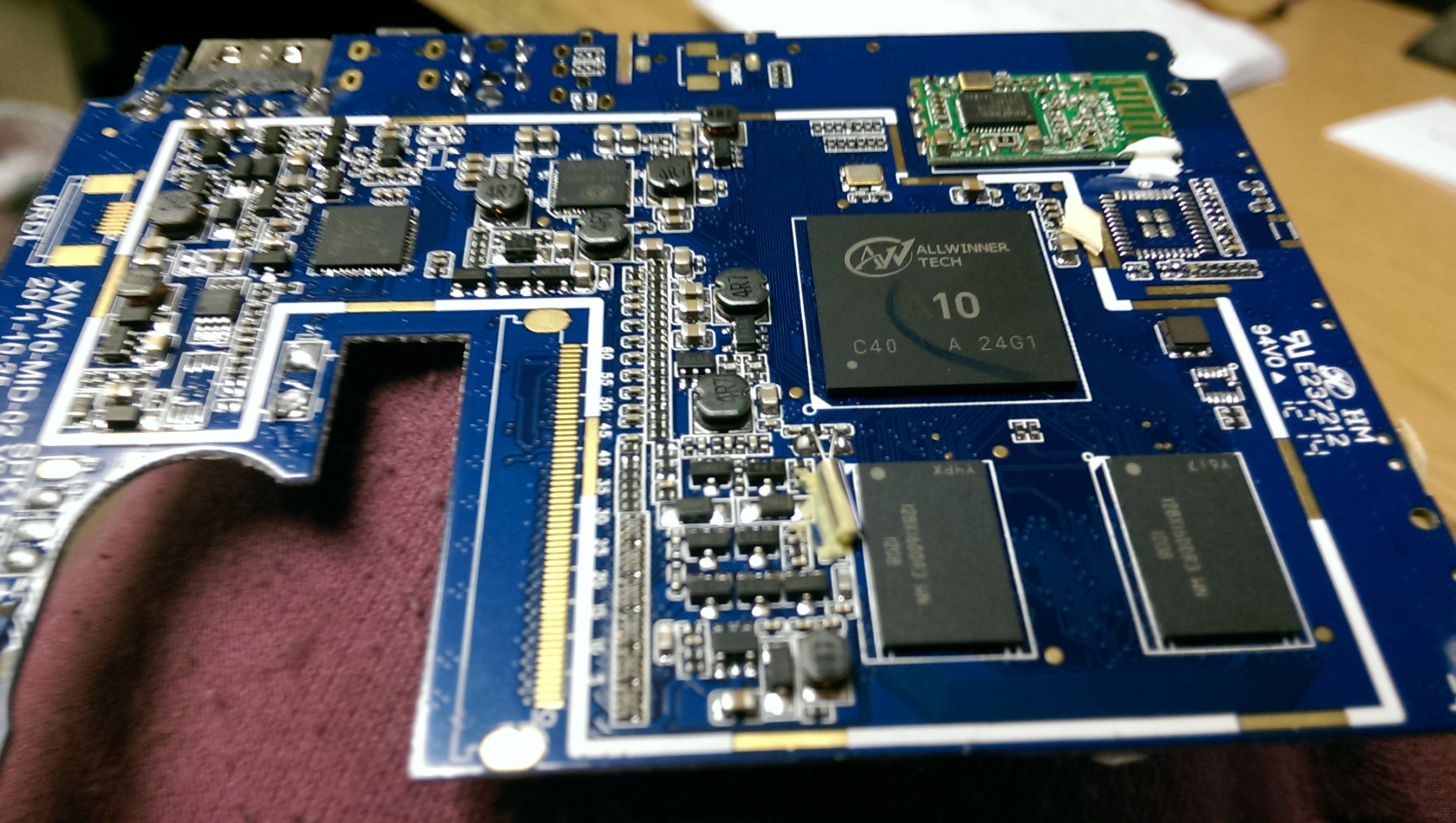

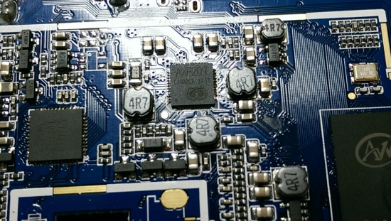

 Post subject: Re: Unable to find Spare Area for Micron FT32G08UCM1-15
PostPosted: October 8th, 2017, 12:32
Posts: 191
Location: Sweden

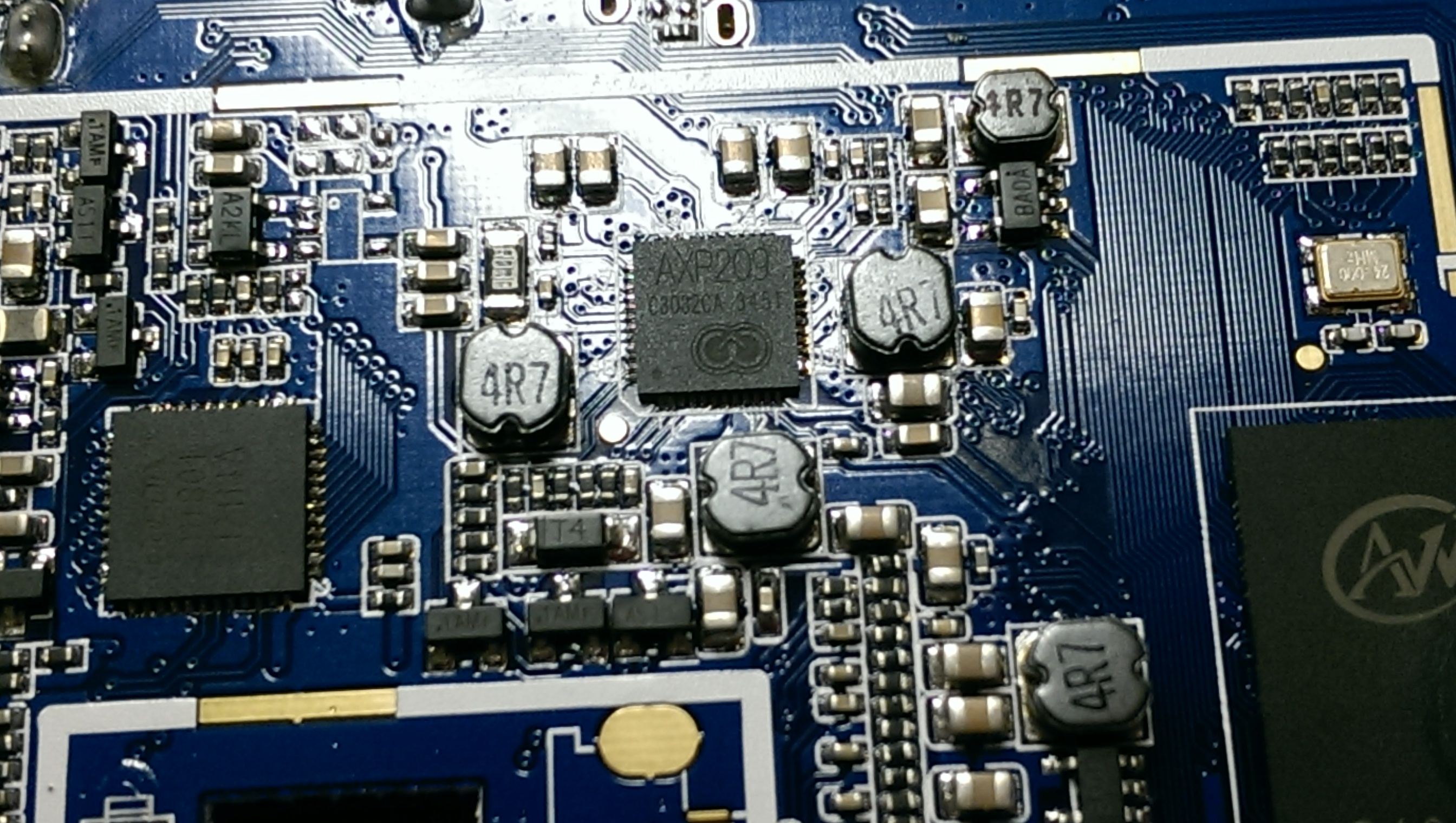

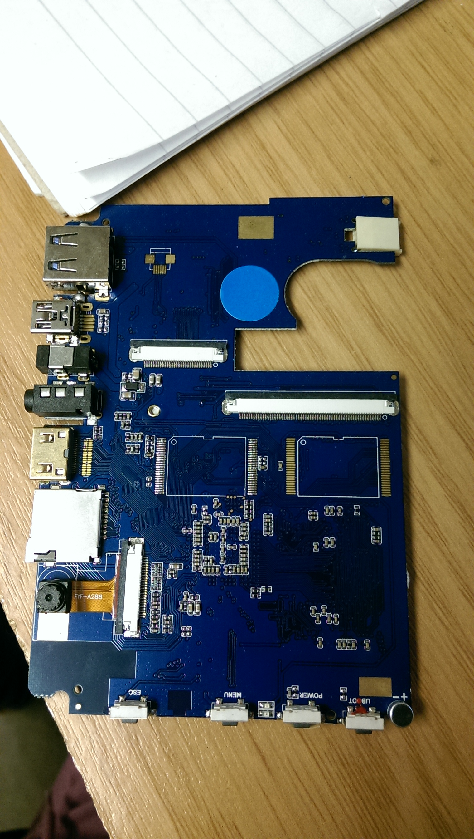

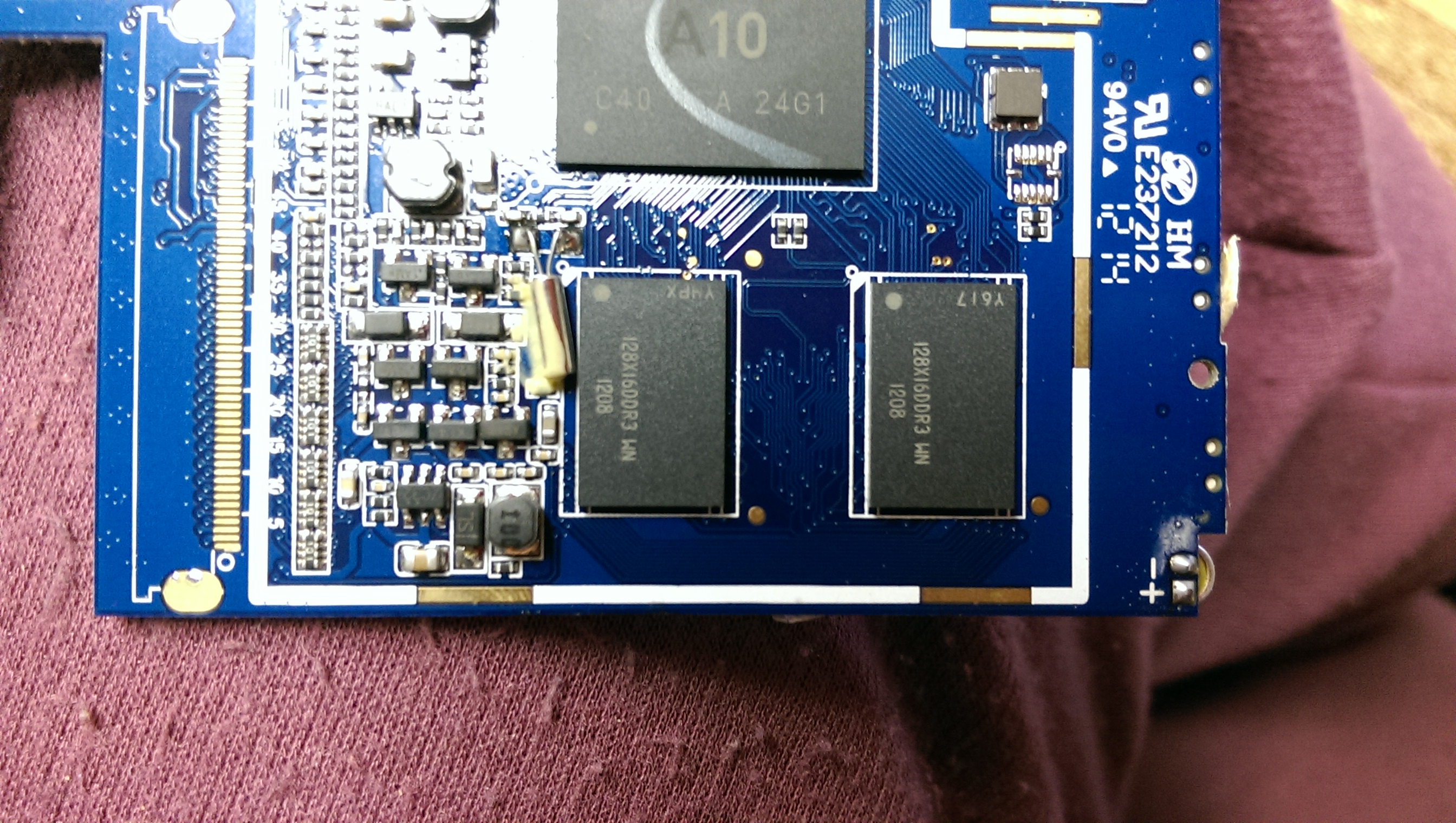

@sasha: Here are photos of the board. I have unfortunately only a phone camera accessible right now (potato quality), but I hope it works.

It's OK, do you know by chance model of tablet for the record?
https://we.tl/lVFKAp0Htl
Here's a case files with solution, replace yours, open it and:
1. Physical image element - replace path to file to your dump
2. BCH element - turn power ON
3. Markers table element - open table (top toolbar) find the button OPEN at the left top corner and load markers table 0.xml, then go back to workspace.
4. Markers table element - click red button CREATE LOGICAL IMAGE.
5. Logical image element - open file system viewer from the toolbar
Now you got access to file system and files of 3Gb userdata partition
P.S. There are multiple partitions on device since it's Android, but there's no MBR/GPT looks like partition layout is stored as fixed offsets somewhere in the bootrom (don't want to dig that deep now, it's Sunday evening :wink: ).
PostPosted: October 8th, 2017, 14:39
Posts: 17311
ALLWINNER A10-EVB-V1-2 REV 1.0 SCH:
https://elektrotanya.com/allwinner_a10-evb-v1-2_rev_1.0_sch.pdf/download.html
Wait for "Get Manual" to appear, then click on it.
PostPosted: October 8th, 2017, 18:56
Joined: July 2nd, 2014, 8:05
Posts: 215
Played around a bit more and realized that I actually retrieved extSD card partition, not a /data one.
Just did rebuild of most partitions including /system, /cache, and /data one and found a partition layout scheme (weird one, never seen before).
Explanation will take a time...a bit nonstandard things..will try to add some info here within this week.
Got a model name, it is Softwinner EVB Crane V13.
Using VNR's Android data extractor was able to retrieve all contacts and that's basically it because device had no GSM module as far as I understand.
