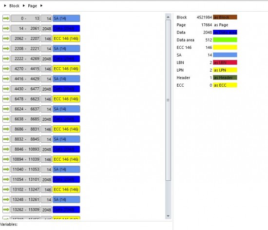

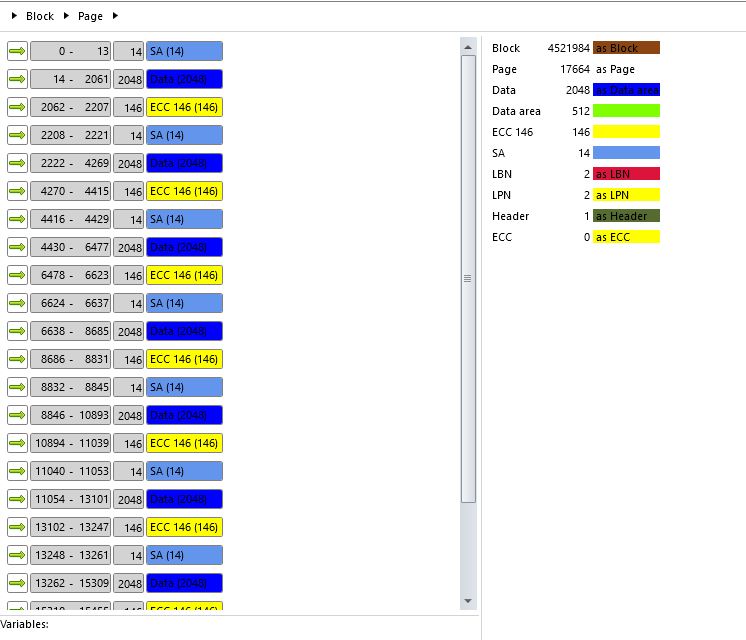

ddrecovery wrote:
Unfortunately the software will not allow it. It will not allow changing block size to anything other than page size. Same with the area size (unless I missed something?).
Any other advice you can give would be appreciated.
 Post subject: Re: Question about Pair Element
PostPosted: October 17th, 2017, 19:35
Posts: 4000

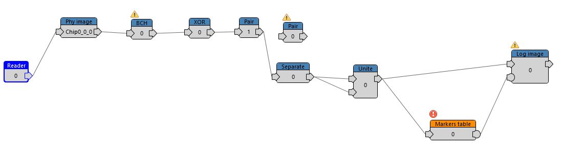

can you post a screenshot of elements window, and include the structure?
I had one where I needed to add banks. I intended to setup like (plane)->(Bank)->(block)-(Page)->(data + SA)
but I could not set Bank. In the end I got rid of plane and started with Bank and it worked. I may have been doing something wrong but if previous elements aren't right things wont work.
PostPosted: October 17th, 2017, 19:51
Posts: 1777
Location: Phoenix, AZ USA
Here you go :wink:

If it is standard Sandisk, you don't have to split dump, so Separate element isn't necessary here.
I need to know one more thing: can you tell me or make screenshot of parameters of first pair element.
Also, can you explain me why you cannot edit parameters of pair element? This element has three fully adjustable parameters. You can change text fields of this element by pasting there value.
If to two inputs of unite element you connect same dump, in results, depend what parameters you type, you will get JBOD or RAID0.
