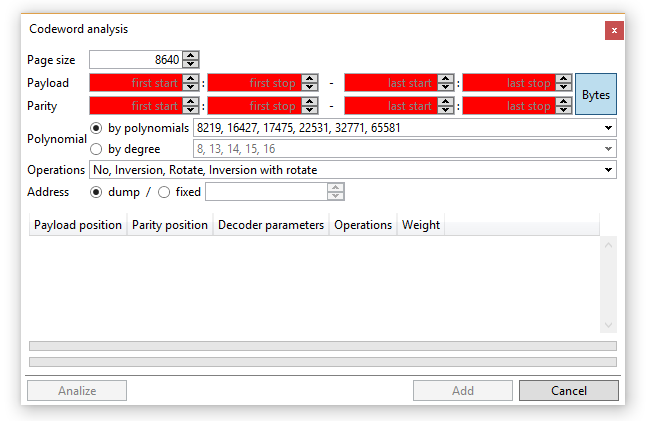

Can anyone explain how to use the new codeword analysis tool in VNR?
I have a 20-82-00162-3 controller which I think is pretty new as I cannot find references to it.
I may have the same issue with XOR.

 Post subject: Re: New Codeword Analysis
PostPosted: January 22nd, 2018, 15:25
Pretty sure that controller is encrypting, so you won’t find XOR.
Ahh. That explains it. I guess i'll be on the hunt for a donor then. Thanks Sean.

What was the issue with the device originally?
PostPosted: January 22nd, 2018, 16:05
Posts: 1777
Location: Phoenix, AZ USA
Broken connector and some damage to the board unfortunately.
PostPosted: January 22nd, 2018, 16:21
If the damage is not repairable or you cannot tap into the broken tracks, then as you say you’ll need a donor to switch the NAND chip onto. :-)
