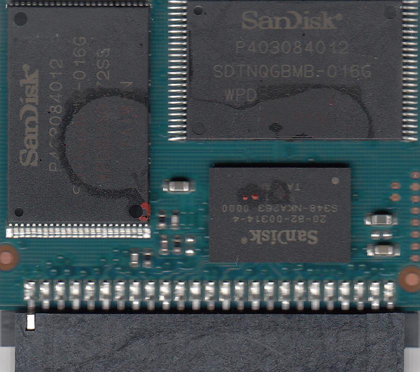

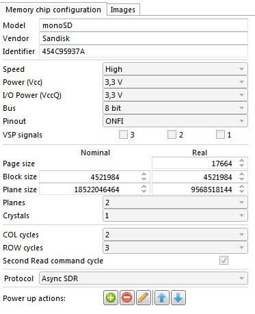

Hi Forum,
I have a Sandisk Ultra 32G CF Card. It uses 2 SDTNQGBMB-016G NAND Chips.
The controllers seems to be defective, but I have good hope the NAND chips are not impacted.
The VNR Reader does not have the SDTNQGBMB-016G in its database.
If I use the settings from SDTNQCCMA-064G, it can read the ID, and I can see data in the dump viewer.
It does not read any ONFI Parameters however. (And since the device has a different capacity, I don't know what parameters (page/block/plane) will differ, but it can not be the same)
I can not find any datasheets of these chips. Is there anyone who has the correct parameters of this IC?
Next part;
The controller used in the CF card is a 20-82-00314-4 The VNR has a sandisk CF with the 20-82-00309-3 controller in its database.
Would those controllers be the same to decode? If not, does anyone have the correct decoding method for this card?
My first instinct would be to just try to find the same model of CF-card and transfer the NAND's, but I bought the VNR to not depend on that strategy :-)
Thank you !
File comment: Config

File comment: Sandisk Ultra 32GB Internals

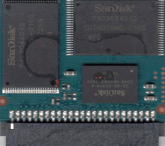

File comment: Sandisk Ultra 32 GB

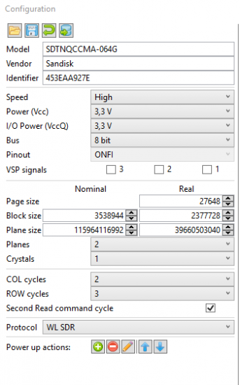

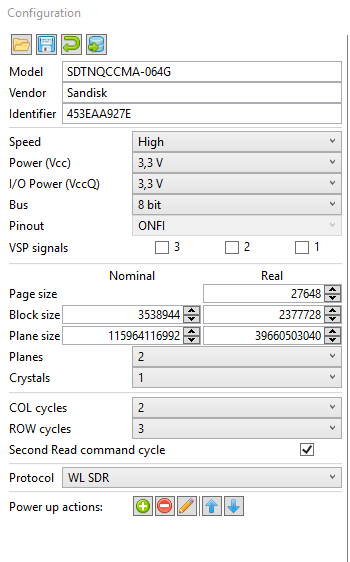

There is config for this ID:

 Post subject: Re: Sandisk CF Card Ultra 32G (SDTNQGBMB-016G NAND)
PostPosted: March 22nd, 2018, 20:06
Joined: March 15th, 2010, 8:42
Posts: 9
Location: Belgium
Thank you for the tip's and pointers.
I was indeed confused that the Chip ID was foud 3 times in the database. Therefore, I tought that the phisical form and type number of the chip was the most important, not the ID.
There are 3 entries in total. 2 entries in the database have the same parameters.
The "MonoSD" one does not seem to work, the reader goes in error state after reading the first few pages but the "monolith" one with different page size does read the first NAND chip.
Now trying to read the second chip. I had some difficulties reading the second chip on the first try, but lowering the voltage seems to pursuade the chip to read.
Kind regards,
Hans
