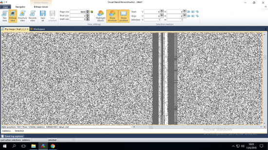

Hi everybody how are you?
I have a case, its an old kingston pendrive of 4GB, the controller is a tc58nc2250g6f and the memory id is 98D7943276. The memory is in very bad shape, in the LBN i see a lot of bits fliped, i am trying to improve the reading by lowering down the voltage and lowering down the speed but the outcome is still the same. I am attach a print screen from the SA, any one have a similar case and can improve by lowering down the temperature. I am thinking buy a peltier celd to do experiments.
My best regards to everybody

RR should help, and different voltage on VCC and VCCq.
