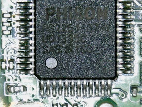

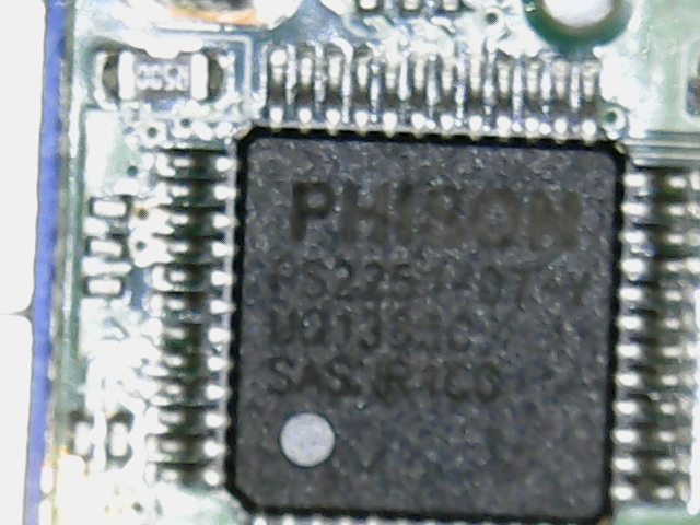

I have a problem recovering files from a Kingston USB pendrive.
Memory chip is a:
Hynix
FT64G08UCH1-09
ADDE94DA74
Controller is a Phison ps225
I had the training from rusolut but forgot everything. Does anybody have a walk through for that one. At the moment ECC caused me headaches it is 77 bits but software complains about that also I do not think this one is xor and just an inversion. Any input welcome.

This will require XOR (bitmap view should show this). Also for ECC, if I remember right the first SA is larger than others so if this is not defined right ECC wont fit. Maybe this is whats wrong?
