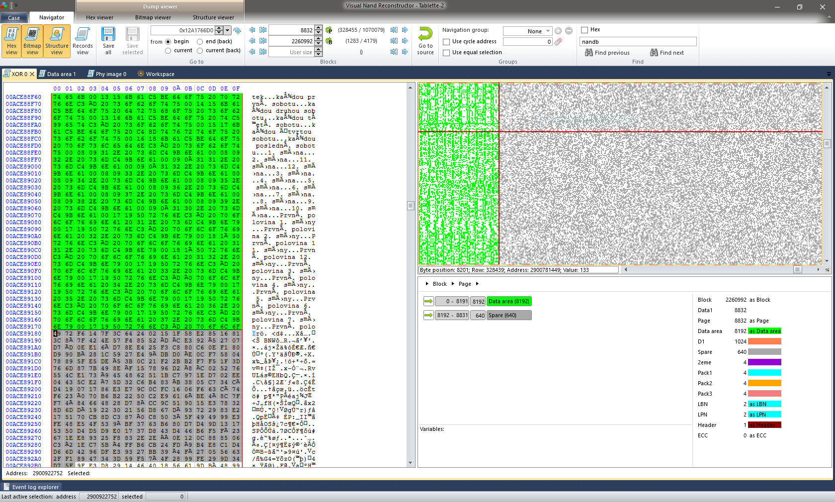

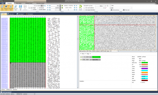

 Post subject: Re: Allwinner A13
PostPosted: December 5th, 2018, 17:26
Joined: November 5th, 2018, 13:44
Location: France - Bretagne
I don't find,
- data area 8192 bytes, only data (when uXored)
- spare area 640 bytes (with the last 48 at xFF)
With bitmap viewer no trace for header, LBN and LPN.
perhaps the A13 controller use tables at the beginning of the chip memory ?
File comment: Allwiner specifications about NFC
A13_User_Manual_v1.5_20150510.pdf [5.66 MiB]
Downloaded 1544 times
File comment: data/spare area on unXored bitmap
Ildut de Parcevaux
+33 619038432
PostPosted: December 6th, 2018, 11:07
Joined: January 23rd, 2018, 7:50
The BCH codeword from MichaƂ was for ECC area equal 50 bytes, the one you have is 70. Also Allwinner xor spare and ECC areas as well and from the point I see you applied it only for DA. Header, LBN and LPN are in first and second spare area.The correct page structure will be: DA 8192 (SA 4 ECC 70)*8.
