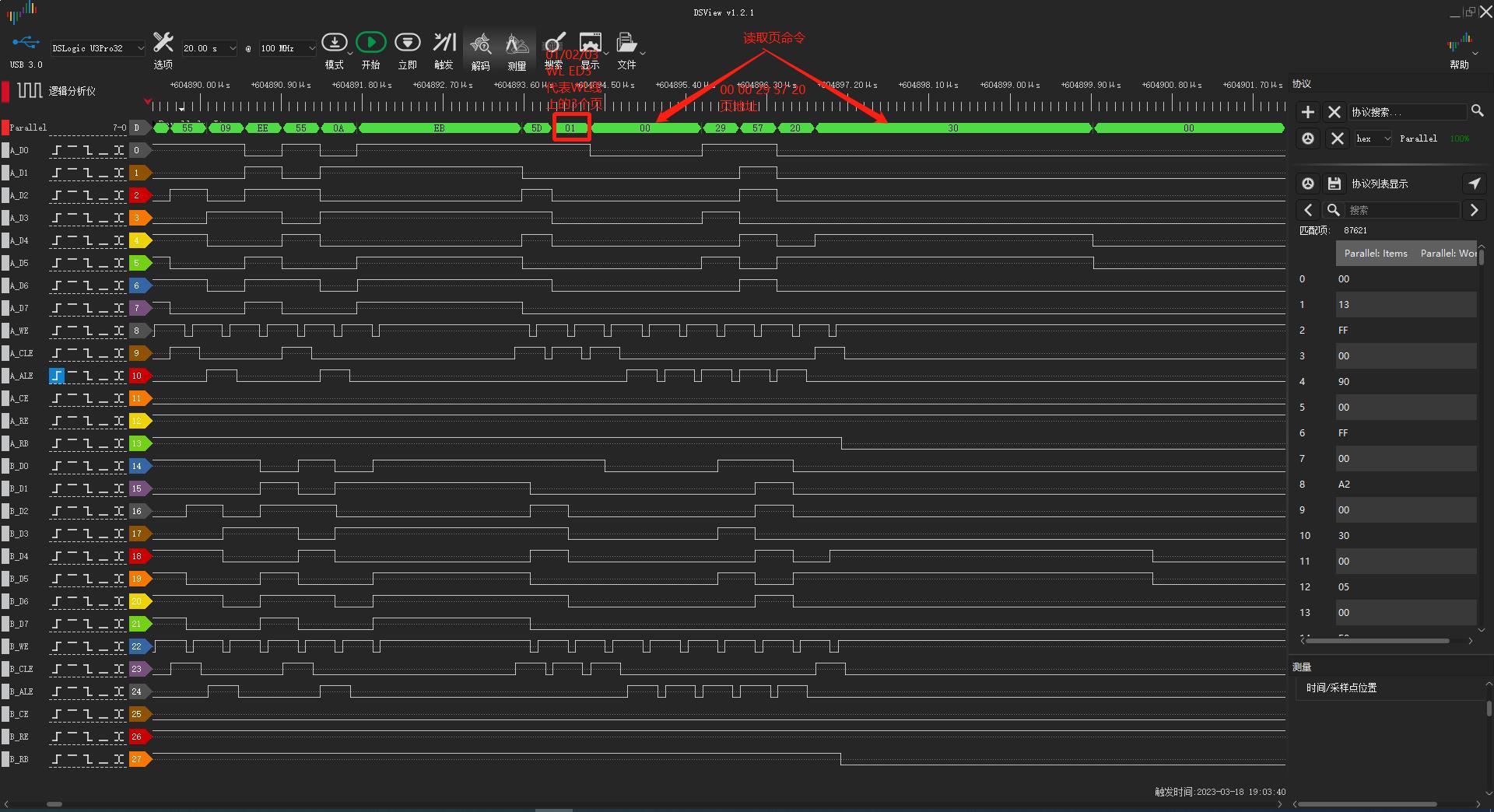

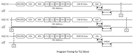

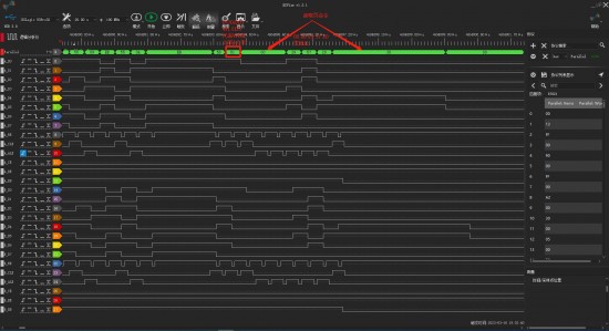

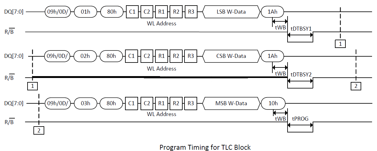

 Post subject: Re: Toshiba Pendrive - Steps to follow.
PostPosted: March 21st, 2023, 0:24
Joined: July 8th, 2019, 12:27
Posts: 162
Location: 中国大陆浙江省湖州市
Modern chips such as TLC are divided into 3 pages on word lines. Each page has a separate address on the WL line. Such rules are called WL.The corresponding rules must be followed when reading pages and programming to pages。 Of course WL should be a vocabulary created by a developer engaged in flash data recovery. For flash memory manufacturers, a more accurate term should be called ED3 (Toshiba, Samsung) or OBP (Micron, Intel)
http://flash-matrix.com/
