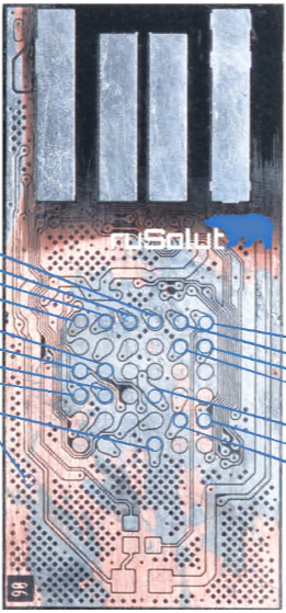

Hello everyone.
I am trying to recover this flash, but missing WP pin from the diagram. I don't have logic analyzer here to find it, maybe one of you has it?
Help much appreciated.

yco wrote:
Hello everyone.
You usually don't need need the WP pin.

yco wrote:
I am aware of that. This chip has a lot of byte errors. I played with voltage levels without positive results. I was told by a colleague that actual read-retry routines in VNR won't be effective without WP signal. Is that correct?
IMHO no :) Try read this dump with slow mode or connect VCCq instead VCC.
I will try that tomorrow.
