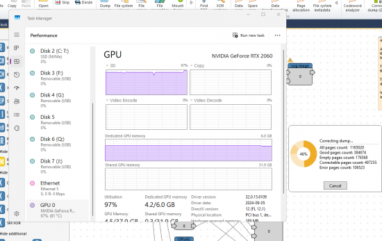

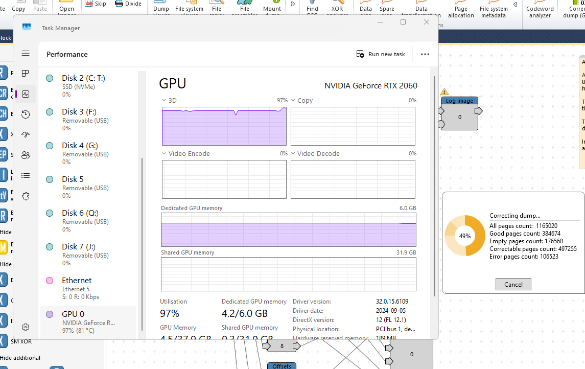

Maybe I'm doing something wrong in VNR 9.0, but when I use GPU-correction I see no increase in processing time at all. In the machine is an i7-13700 (16 cores, 24 logical) and an NVidia RTX 2060. Testing GPU-correction on a 16GB chip is just as slow as using the CPU-correction. Only difference is that the GPU-version reads a larger chunk of pages at once while the CPU-dito reads a smaller chunk. But speed-wise, both are the same, despite task manager showing "100% GPU usage" (instead of CPU).
On https://www.youtube.com/watch?v=a8ExeJ90Cac there is a comparison where they end up around 48 minutes for CPU-correction on 4GB. Extrapolating to 16GB it's 192 minutes, and that's about the speed / time I get when using either CPU/GPU for this case.
Is there an error log or similiar I can check, to find out why the GPU-correction is slow as a dino?
(screendump shows GPU-correction after about 90 minutes run)

GPU ECC came out 5 years ago, and Id like to know what the results are on current graphics cards - does anyone have such data? I personally only use CPU. I tried GPU once or twice, but it ended up damaging the dump. It would be great if someone could share their experience on this topic. Does anyone have the same issue as @bos? Thanks.
