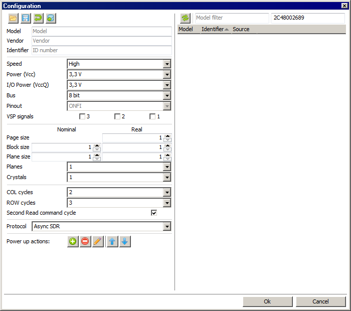

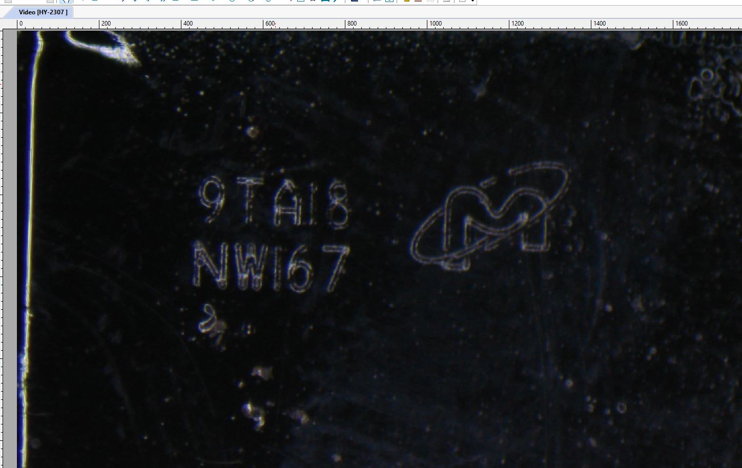

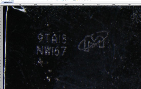

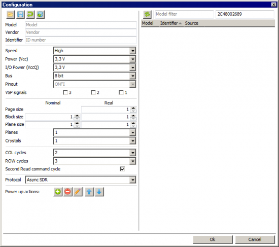

32GB SSD, "Solidata" with 8 BGA100-chips. VNR (v2.4) finds ID-number 2C48002689, but I find no matches in the database and I find no info on google about the chips. Never seen this kind of logo before (see attached image from microscope).
Does anyone know what settings I can/should use to dump it?

Update: manufacturer logo seems to be Micron Technology.

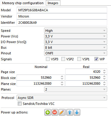

Its Micron. Upade your DB. Here is the config:

You can search Micron's database as follows:
https://www.micron.com/support/tools-and-utilities/fbga?fbga=NW167
NW167 = MT29F32G08AECBBH1-12:B
