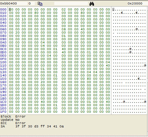

Hi, got this mSD 8GB that i'm stuck with. Dump looks quite good when i see SA but ECC i found gets me this strange pattern. Like 2 blocks are bad one good etc. It looks like dynamic XOR but i'm stuck on dump correction.
Does anyone have a clue what might be wrong here?
It's a 98DE989272D7 DDR.

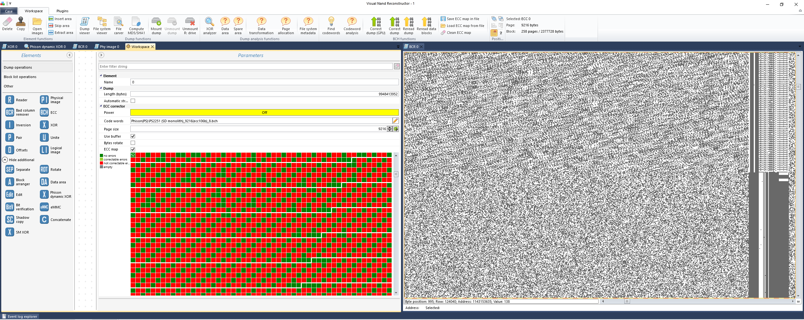

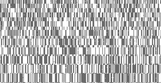

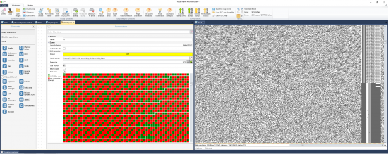

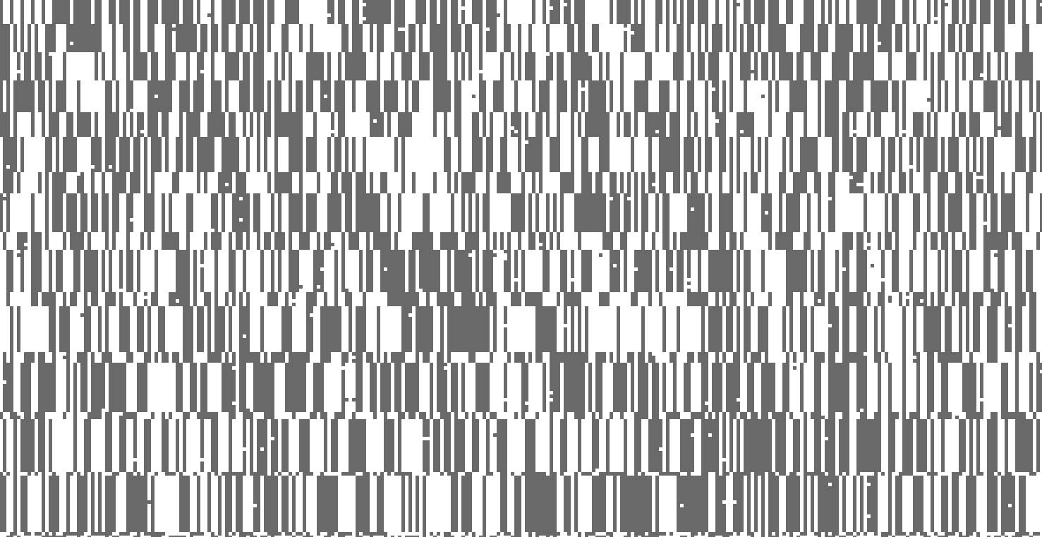

Look on the screens.
At VNR you can see bit errors on XOR block (random "dots" at regullar pattern).
At FE you can see bit errors after apply XOR.
It is bad dump quality and RR should help. This ID usually is very easy to correct. Try find problem why RR not work.
