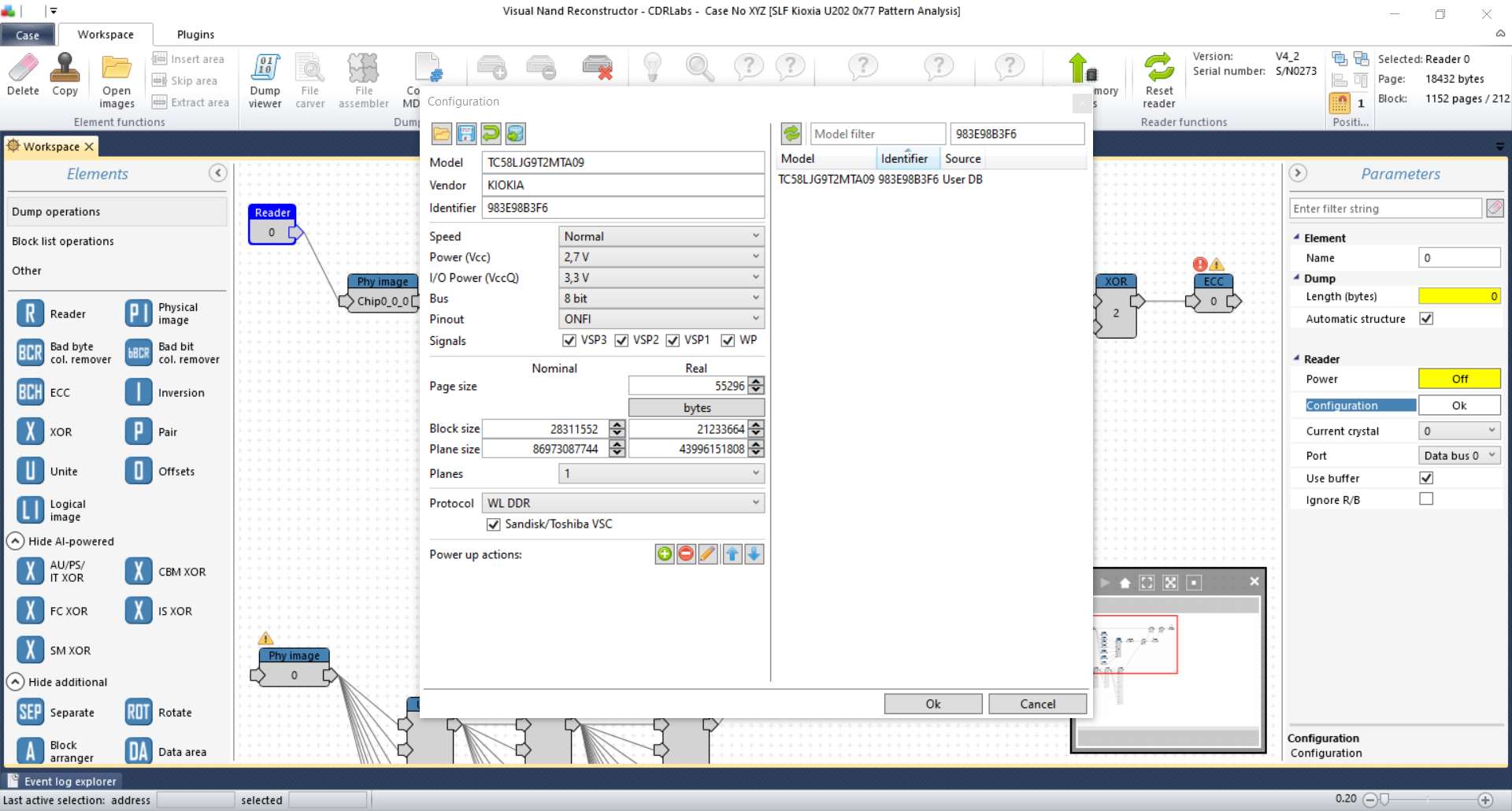

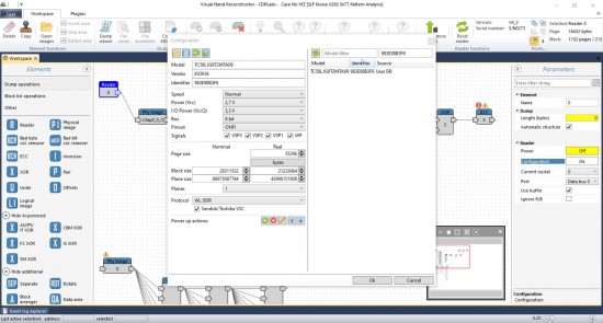

This is a KIOKIA "Toshiba " TC58LJG9T2MTA09 Chip Marking With ID " 983E98B3F6 " . Config of the Chip Is added to post ,No Resources in VNR 6.1 Version as of 5-6-2022 .
NAND Config - >
TC58LJG9T2MTA09-983E98B3F6.rar [794 Bytes]
Downloaded 987 times

Did you recover data form this case? There is many configs for this chip at DB. Update it.

Well,
i use the latest version of VNR [ Alwaysssssss ] , This Config was not in the database its clearly mentioned by me .Config Was Added To my UserDB .These Are Donor Devices i Am Working With ,This Was Just 0x77 Pattern NAND To Find XOR And Config ,ECC will Follow if Its Not LDPC :lol: .Controller is TC58NC6627G6F "Looks Like Phison To Me "Could Be SSS Too

It is a good practice to publish verified resources so as not to mislead others. Please verify it. So far never meet this ID with 983E98B3_F6, always it was 983E98B3_76 or 983E98B3_7A.

Ahha ,
So if Arvika makes resources and keeps saying shared with other lab ,We never know which lab you shared it with ,If we see the number of cases and posts you make daily ,i feel you make about 20+ resources a month ,I am a VNR Fanboy ,in the context of this tool whenever there is a update i never see the amount of XOR and NAND Configs and ECC Codes That you claim you develop and share ,Might be you are sharing to Soft Center And Not VNR as much as you develop .As far as this NAND ID is concerned it does not matter if you have seen it or not ,We have seen it ,We have 3 pendrives with same MCU + NAND ,So we are developing resources Like NAND Config ,XOR and ECC and Share it with all My Friends here ,Is this a crime ? ,it feels as if you feel if something has not passed your scanner its fake , the ID no is 983E98B3-F6E30816 , These are KIOXIA U202 pendrives .We also Have the XOR for these pendrives but not ECC yet ,I need to Prepare NAND Again as VNR Says Not only with 0x77 Pattern
PS : To everyone ,This NAND ID should be available to everyone in next update ,Long live VNR :mrgreen: :lol: ,I am Learning Fast

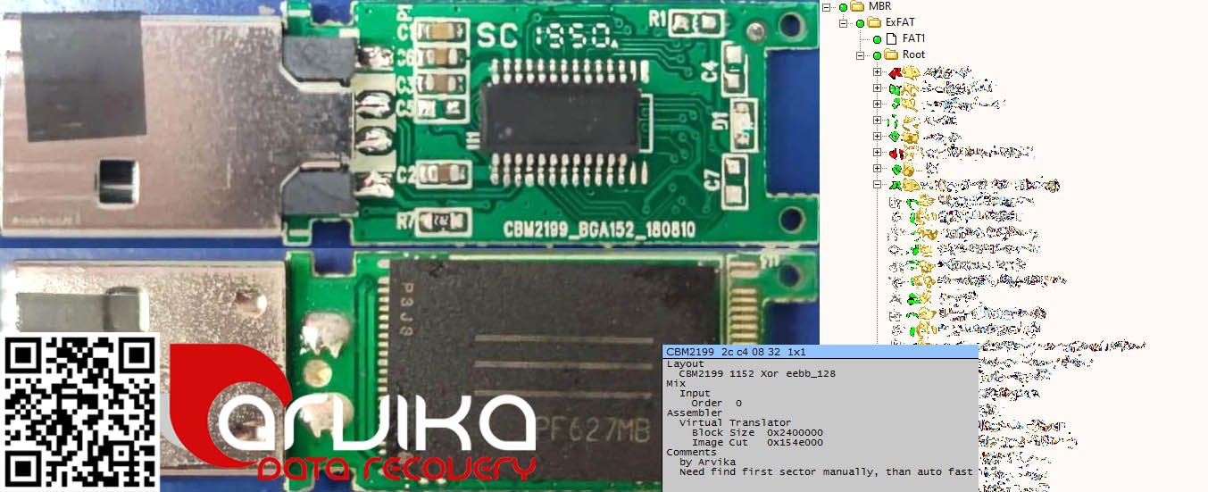

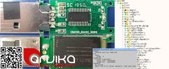

Let's be honest here please Amarbir, Arvika shares them with other labs, not perse with developers of software (FE, VNR, PC3000). He shares with other labs, which is factually true, example:
It's up for grabs for anyone, so indeed the solution is shared with the world, any lab can use it. Let's not turn this into a pissing contest.
