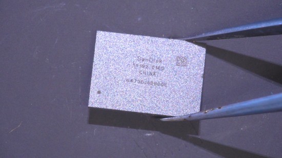

I have a SanDisk Cruzer Glide 16GB with the following NAND (see attached pic). It is a BGA132
Wired it up and chip ID reads as 454CA4937A. I cannot find this in VNR database and cannot find a close match OR any documentation on NAND model from info printed on IC.
Has anyone come across this one before and know the config for it?
Thank you.

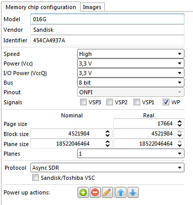

Check this one.

I believe everything is correct except block size on mine seems like it is actually 8
Thanks!
