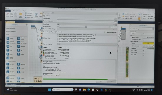

Hello Friends ,
Working on These SSD Is Not easy ,As far as i know Arvika , Melvin have worked on some cases .Here is melvins video that he made in his native language -> https://youtu.be/QYfeD9TcQyA . I would like to ask you what are your final thoughts on VNR Vs FE . I could not understand the dialect .
SG Data " Video "
In This video melvin has a Different ID NAND ,In My Case i Have " 45489AB37E6B081E " . The Readretry he uses is RR-13 ,I wonder how you figured that out melvin that you needed RR-13 .I have tried one pass of RR-17 that the tool suggested for my case and final result was a lot of corrections but not even remotely close to the percentage of corrections you had .I have a Image to proof Rusolut Tool Gives Wrong Statistics In Every Readretry Pass ,Here Watch This Please

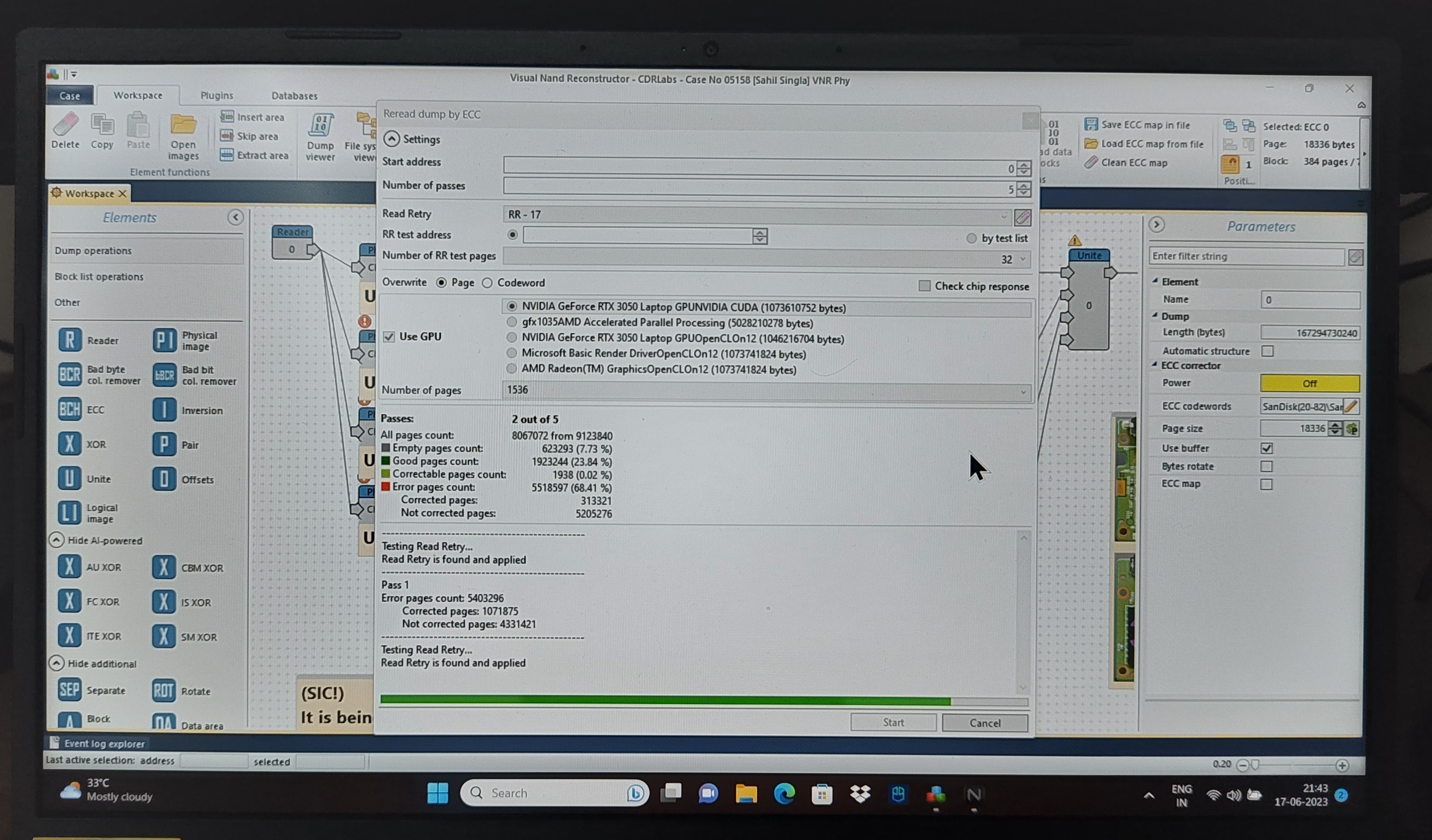

In This In the first pass Non Corrected Pages Are 4331421 , So how come in the second pass Non corrected Pages are 5205276 when 313321 are already corrected .I hope Rusolut engineers work on the tool ,by releasing a new update .
My Exeriements :
@ Read NAND U5 With 3.3 Volts VCC and 3.0 Volts VCCQ " Chip does not work with VCCq @ 3.3Volts
@ Reduced Voltage to 3.3 Volts VCC and 1.8v VCCQ as per a chip config i saw in VNR NAND Database "Read Speed Was High "
@ Done 2 Passes of Readretry RR-17 with absolutely Horrible results .
@ Read U6 With VCC 3.3 And VCCQ 1.8 at low speed " ECC correction going on on another system and Reading U8 On Main System with same parameters .
PS :
Tool Hangs If we select Internal GPU in two of my Laptops With Ryzen 4800 and 1650 GPU And Ryzen 7735 With 3050 GPU .Works if External GPU is selected , Tool Crashes again and again when GPU's are selected ,Its a Pain In The A** . In The new laptop i purchased tool even crashed if correct dump "GPU" is selected, forcing me to use only CPU mode for these 128GB NAND Chips Damn . Also melvin i see you use a BGA 152 adapter is that a rusolut adapter you are using ,Can some of you folks share your rusolut Zif adapters photos

Show your reading settings

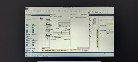

You Mean NAND config or Readretry Settings

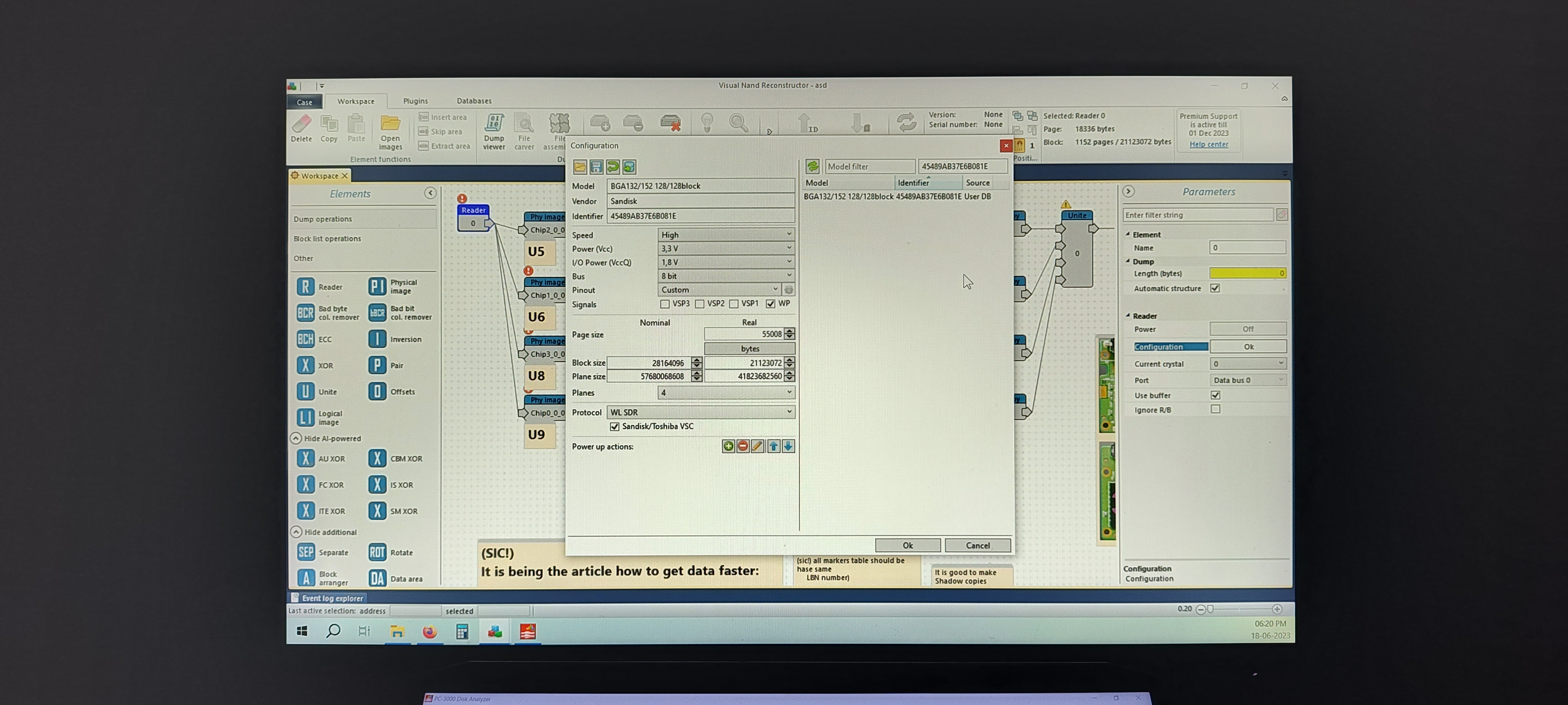

NAND reading settings
Alright ,
Here you go Its a BGA 132 .

Did you check with Rusolut if your config is right? If it's not, ECC will not work properly. Yes, there is still problem with their maps. You can reread dumps few times and still get correctable ones. I already wrote to the support that amount of uncorrected pages can be different in every pass.
As for GPU first option - CUDA should work fine. It cannot be used when CPU is selected.

Yes ,
Even Arvika Told Me That Sandisk_BGA132 Config is correct for this one ,Alexy Taran Did check the case by connecting to system also .The problems with maps are simple to correct " they just need to improve their maths " Lol . These Simple Coding issues should be solved ASAP .As far as GPU is concerned Why Do they even have a option of using CPU " Internal GPU" if the tool will just hang ,Not only this just by pressing the ICON element Correct Dump " GPU" On a Windows 11 PC On My New Acer Nitro 5 Ryzen 7 7735HS Laptop The Software behaves like this "Crashes " ,Also can you explain please what were your demonstrating in the VNR vs FE Video With Sandisk SSD Controllers .

I was comparing both tools and how they solve Sandisk based SSDs in this video.
Don't know why you have so many options in GPU but i think there may be a problem with drivers. Also having two GPUs might not be the best option. You can always ask Rusolut why RR doesn't work good in your case. Might be that chips were overheated or just in bad condition. Check in FE.
Also i use GPU only for correction. Reread only on CPU.
You can always use FE and it's ready solution. Read one chip, find proper RR, read all memories few times with different RR, ECC combine and save the image.
