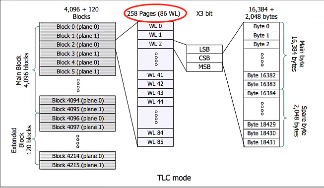

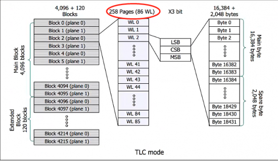

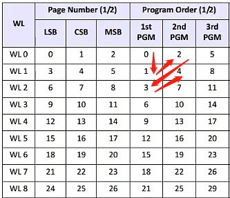

why does WL SDR real block size follow a A.P (airthmatic progression while reading the pages?)
ie follows an​=a1​+(n−1)⋅d
where an is number of pages read. a1 = 2 and n is real block size and d is 3.
Where is it referred in ONFI standards? Can some one put some light here?

This is not a knowledge point required for data recovery work (at least not at the current stage), so it is not necessary to understand it. However, if debugging, designing readers, and writing protocol decoding are required, then the foundational knowledge is necessary. Hynix and Toshiba NAND flash use the WL mode for addressing (read and program). Reads can be non-sequential, but programming must follow the prescribed rules.

Thanks for letting out the information. It's intriguing enough for me to explore and learn more.
