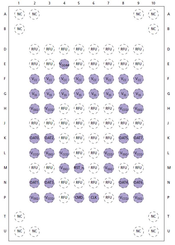

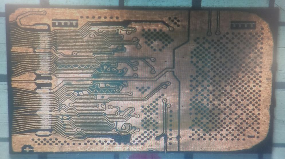

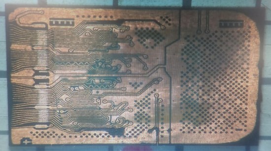

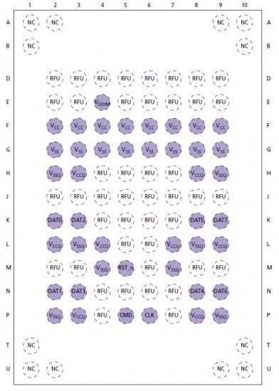

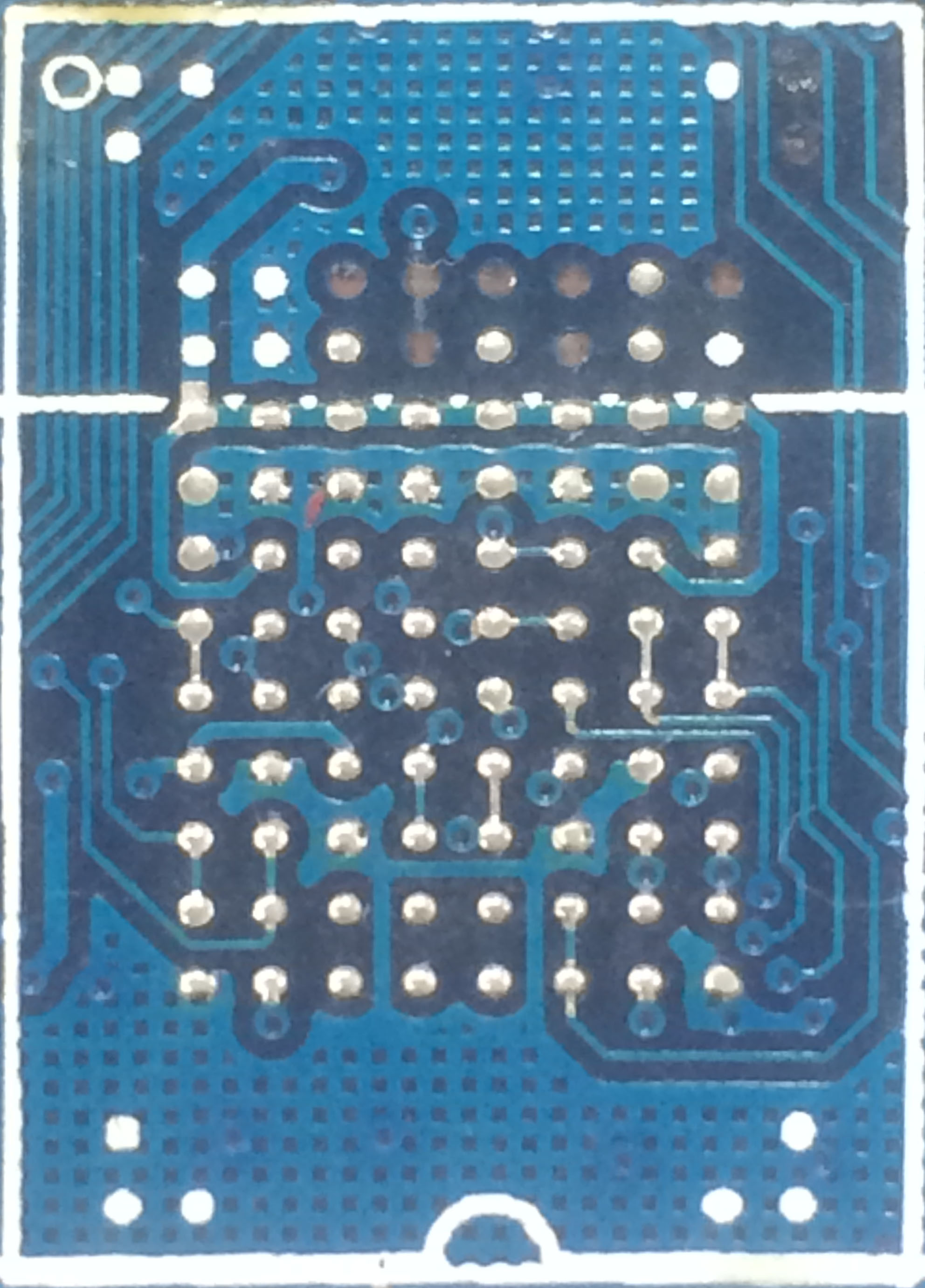

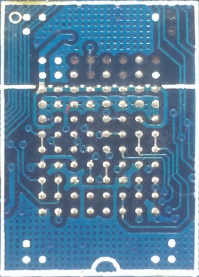

do you know what pin is this BGA???
it was on SD card.. customer said is an BGA100. but the pads doesnt match with the bga100 stencil

thank you very much. do you think is VBGA100?? the pads still doesnt match..................
im very very confused. do you have similar experience???

its match with Micron BGA100 pdf - just two channel sharing this same lines on your SD card PCB

Sir the pads doesnt match with BGA100 stencil
 Post subject: Re: BGA100 PF516 manufacturer help
PostPosted: October 18th, 2023, 20:46
Posts: 4000
is your stencil a 10x10? maybe look at the pitch of the pads and match it up with a stencil that way. possibly a BGA88 might match
