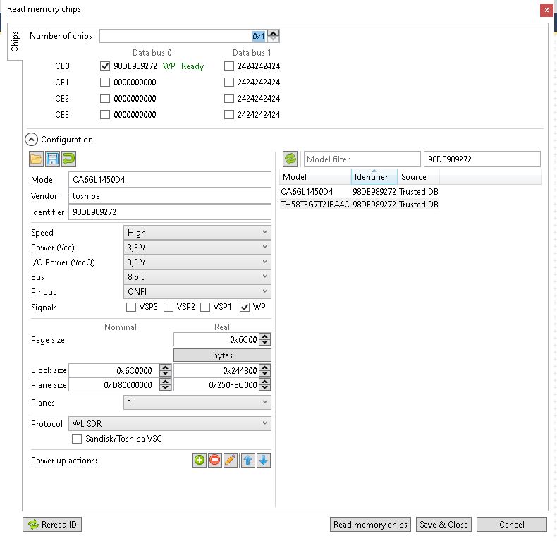

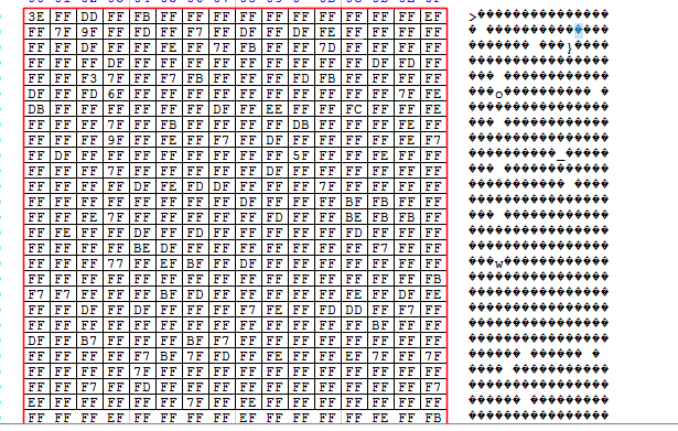

Location: japan
hello guys im strugling with an TSOP-48 from a generic flash drive with a cojtroller PS2251-03-Q U01424C
does somebody know how to deal ith this guy? it seems my rusolut version 5.1 doesnt have the XOR for it
i have the ECC but it 0.00%......... but even if i apply it i get the "!" mark ... i guess is crypted data???

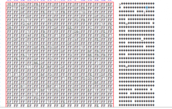

do you see any data-looking areas if you scroll through the dump? 1.png shows an almost erased area...

Frankly speaking, such inquiries are ineffective. You should provide essential information:6-byte ID、controller and flash markings、the number of CE in the chip、the parameter configuration of the chip you are using、the code structure、 XOR signatures, and provide a complete dump or several blocks for analysis.
And whatever it is, it's not scrambled.

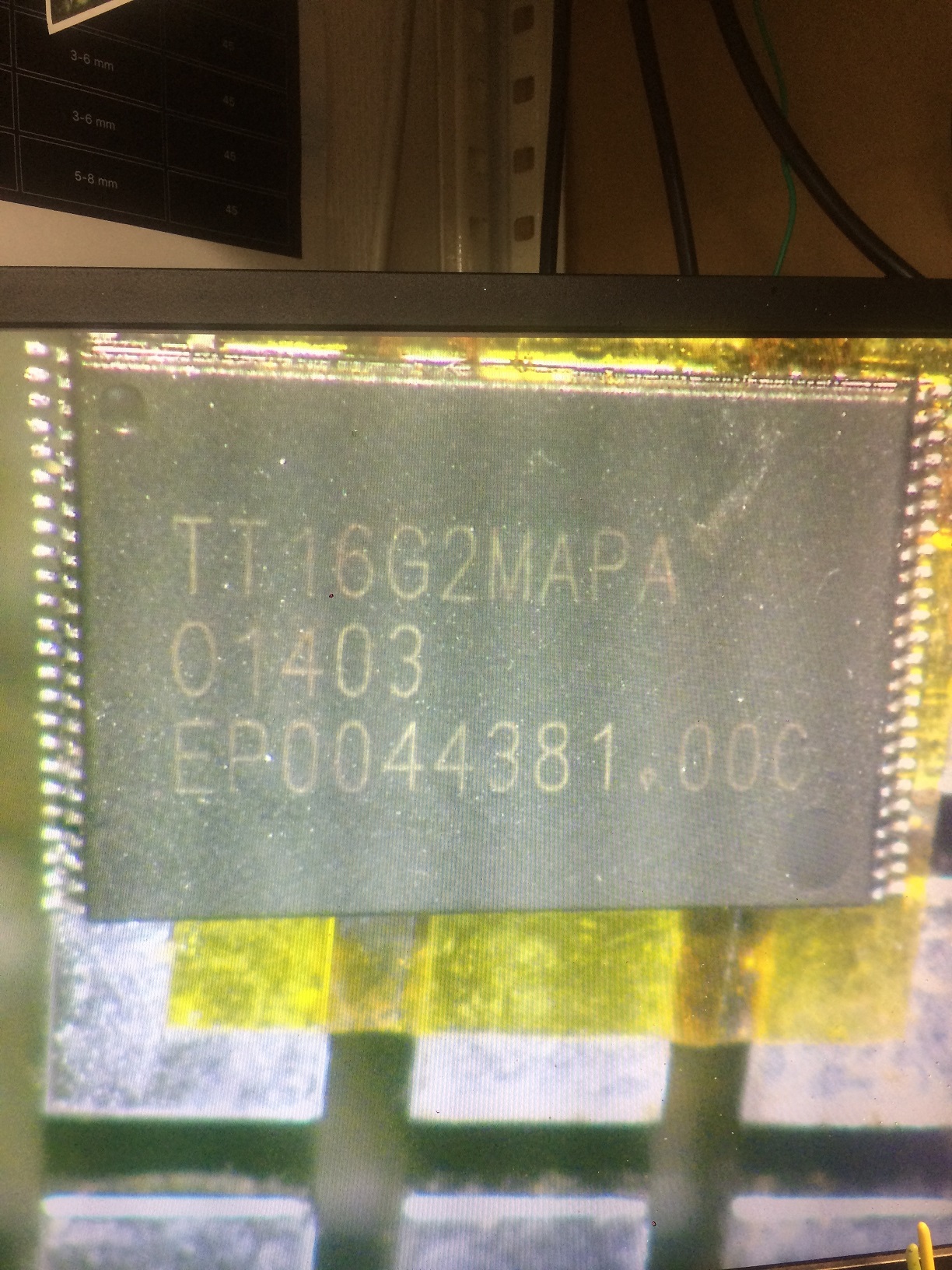

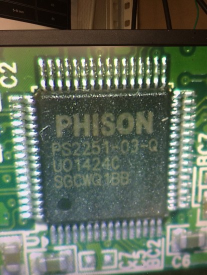

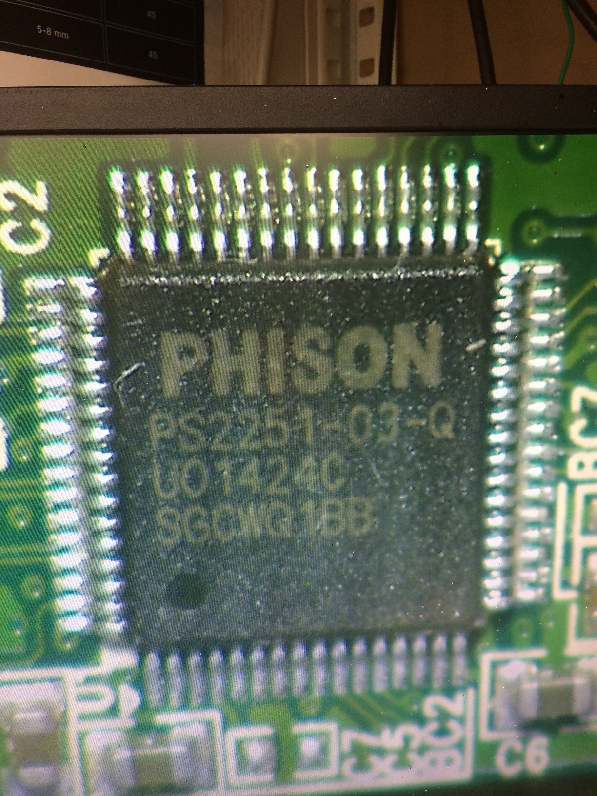

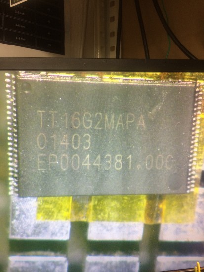

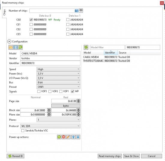

Controller : Phison PS2251-03-Q U01424C
NAND : TSOP-48 98DE989272 one crystal
if i get compatible ECC and XOR file i cann give a try :o

Don't feel bad, apart from maybe 1/2 dozen people, we are all Beginners. Flash takes some serious work to come to grips with. Most of it will be work that doesn't bring in money. Hard to sustain long term, and the more you know, the more you find out you don't know!

The XOR key largely depends on the codeword structure, block size, and controller markings, which aid in filtering the keys. However, few people share them online because XOR keys are typically encoded in software. Except for VNR, which provides keys in file format, any other keys existing in file format are based on individual or team reverse engineering. Therefore, you need to seek technical support from professionals, whether official or third-party, as they can help you quickly resolve cases. You must grasp more principles in this process to understand what we are doing and learn from it. However, this is not easy due to the complexity of flash memory devices, resulting in significantly fewer flash data recovery experts compared to hard drive data recovery experts.

Data-Salvage, did you check if your dump contains data at all?
As for being a beginner, yeah, it is though. One thing is to understand how flash based storage work and another is to be able to use a specific software to get the desired result. Both are critical. I would recommend finding some old flash drives, maybe working ones, with known content and try to recover those with your tools. Yeah, nobody will pay for that in the first place but it is a good start.
Some really old ones (<1GB) do not use XOR (scrambling) and data is almost ok without ecc too, so you only need to read and solve the mix.
