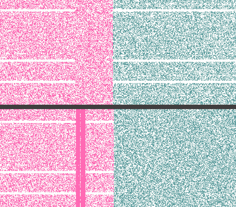

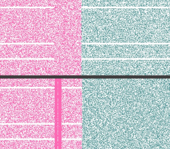

Do you plan to add DM XOR key synthesis in the near future? Recently these controllers have started to appear and what is important is that the XOR mechanism is similar to SM32xx, i.e. XOR is modified by BB. You recently created a new XOR "DM_unknown(18336b_384p_xoredSA_ECC)_1775CE.xor" for our case. I have another case with this XOR, but everything goes wrong when it reaches BB - I checked and XOR is also applied to BB.
Is there a chance you will develop an automatic method for this? It can probably be done manually, but it's a lot of work.
Thanks in advance for your answer.
btw. this white horizontal white stripes are data, in DM, XOR before ECC.
ps. on attachment XOR comparison: top after BB cutout, bottom without BB cutout (pink-ECC, green-data area)

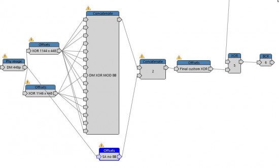

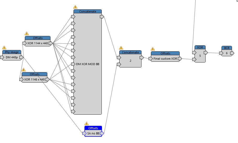

Extracted 20 blocks with XOR, Ticket #6834, I created XOR for my case manualy. I am attaching a diagram of how I do it manually, maybe it will make it easier for you to work on developing DM AI XOR.

Update my reserch, it looks like this XOR will also be able to start from different pages and also alternate inversions of these pages. I have another case with DMxxx but from now on I will call it DM8381 or DM83xx - I see that Arvika had this controller in a non-monolithic NAND with an XOR signature 8E8464, i.e. this signature is second page of the base XOR 1775CE and is in inversion. I now have another case with 5F29F8 XOR which is located on page 187 of 1775CE XOR and also has every other page in inversion compared to the base XOR.
ps. our new case not have BB but still need manualy created new XOR from 1775CE because have bad read quality and ofc ECC ater XOR :)
