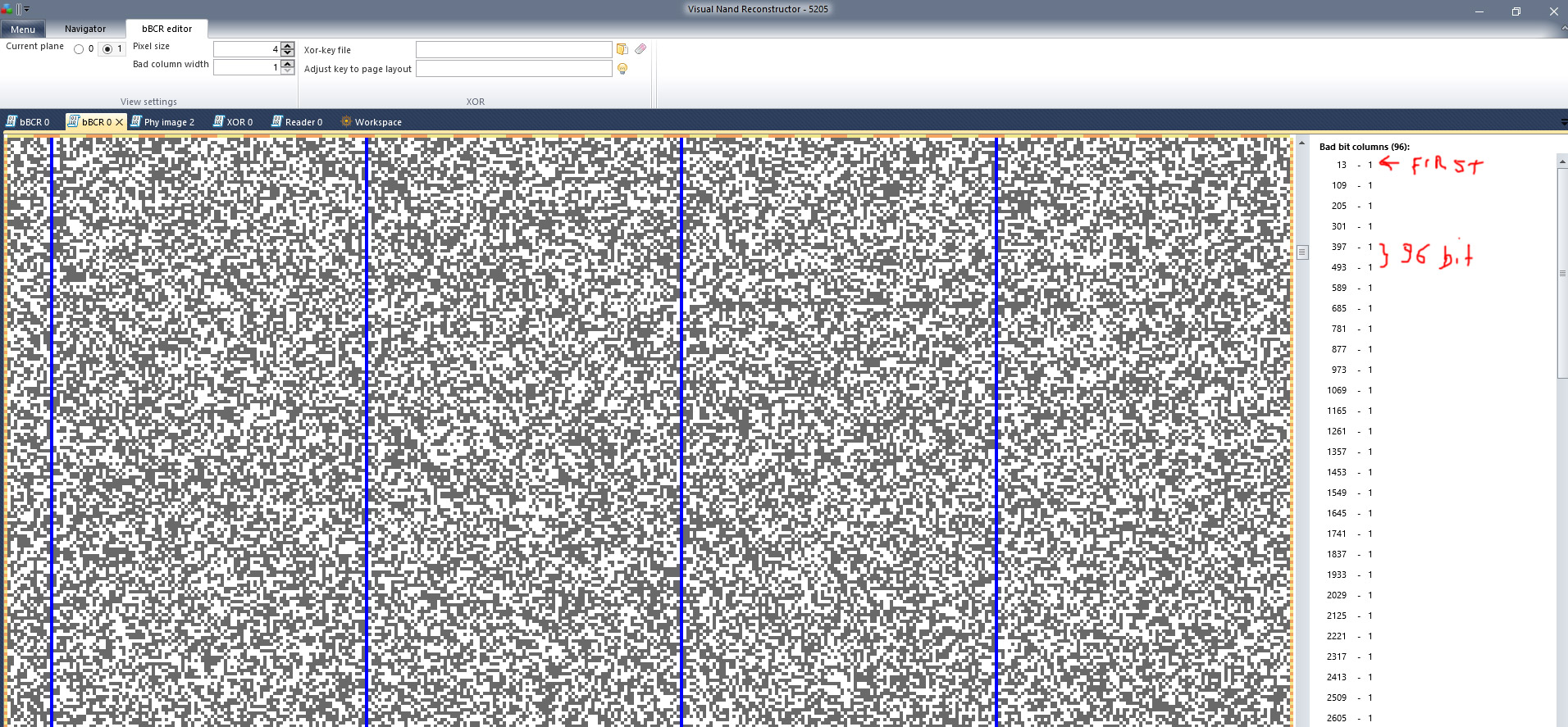

Hello, have you had any experience with periodically occurring bad bits in a damaged plane? We have a new case based on the FC2279 controller, the problem is that the block has 1536 bad bits, cutting them out manually is time-consuming and it could be done with one mouse click after entering 2 parameters in VNR - the location of the first bad bit and the period of occurrence.
Below you will find an example in the screenshot I have attached: in our case, the first bad bit column is in position 13, the next ones are 109, 205, 301... etc. so the period is 96 bits.
I think it's nice that a function has been implemented in VNR that will do it for us automatically.
Is it possible to develop such a function in VNR?
ps. after removing these bad bits, I have ECC and I can see the data, so it is not a garbage block.
Best regards.

That is impressive that you removed 1536 bad bits manually :shock:
I think if we meet more such cases, we'll do it.

I have one such case, too.
But my current problem is that I cannot get bBCR to work in VNR 9. No matter how many or which bits I remove, the dump stays 100% identical. BCR working fine.
 Post subject: Re: Function for periodically occurring bad bits in FC2279 -
PostPosted: August 9th, 2025, 5:33
Posts: 922
bBCR was change methodology at this version as I remember. Ask support, as I remember there was some video or article.
PostPosted: August 10th, 2025, 12:43
Posts: 4840
i think you could write a script to generate the textual description of the bad bits and load it into vnr. Probably you need to copy it into the task xml.
