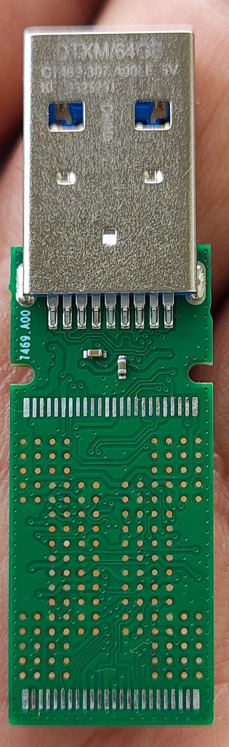

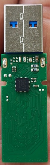

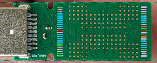

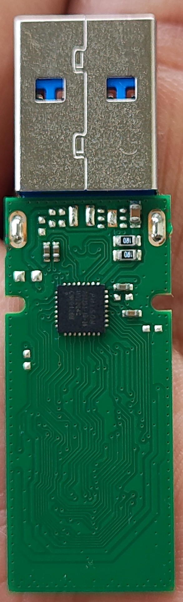

Friends ,
Sharing Some Images of The Circuit Board

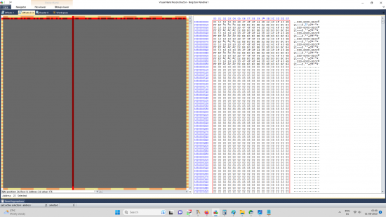

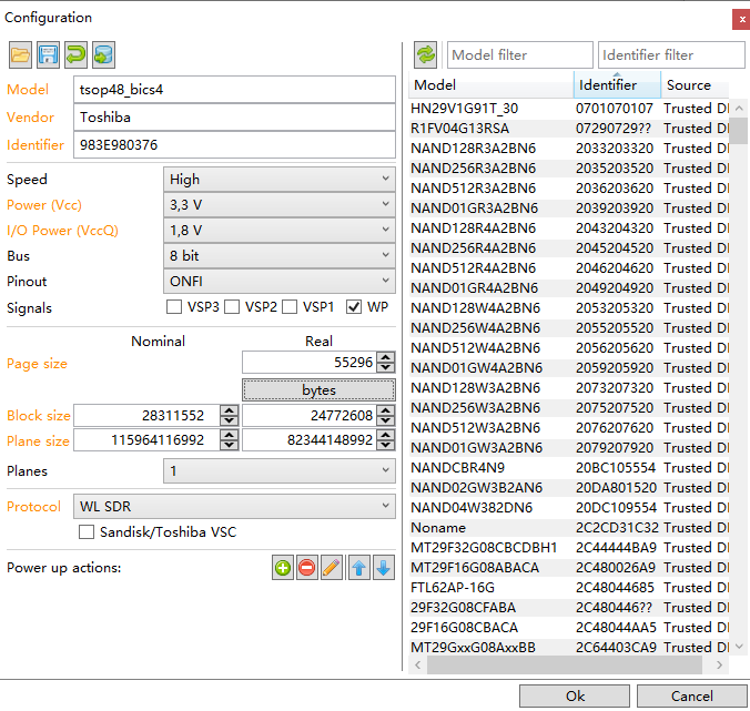

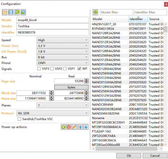

The difficulty lies not only in correctly reading the chip, but reading the chip is the first step
983E980376E4Chip.txt [948 Bytes]
Downloaded 1434 times
http://flash-matrix.com/

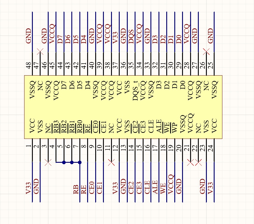

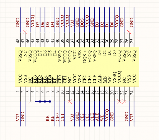

Applicable to your case.Check 1, 2, 23, 24, 25, 26, 47, 48; they may have slight variations across different cases

Hi ,
I have Measured The Pins ,I will post results when i reach Home .VCCQ is 1.2 Volts and The Rusolut Reader Does Not Support Less Then 1.6 Volts ,How Are We Able To Read such Chips Then .
The chip can be read by VNR with VCC=3.3V and VCCQ=1.8V. I am using the adapter I designed, which aims to facilitate the replacement of voltage pins with special configurations. For the 3K, I have read the latest updates, and they have added this chip to the chip database. However, I haven't tested the software with this new addition yet. As for the FE, there were significant issues when reading low voltage chips with the existing hardware. But I have successfully addressed this problem by patch. You can find more information about it on my website.

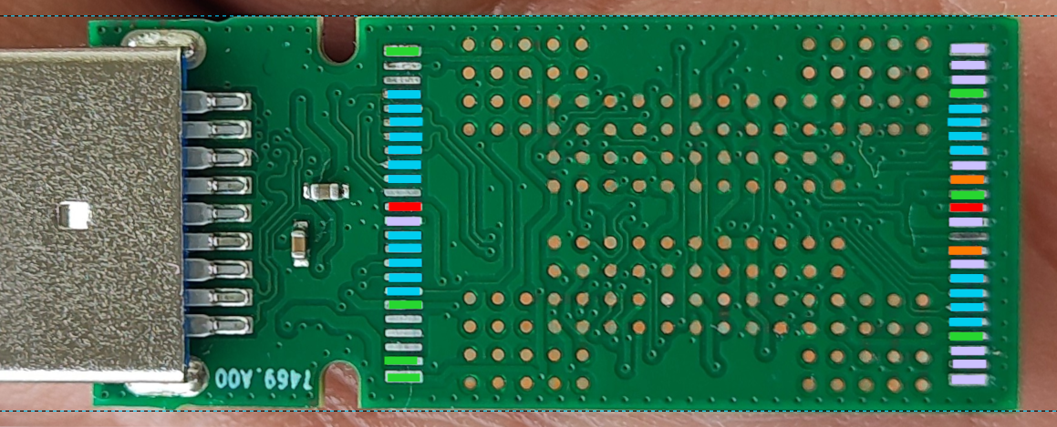

The TS Team of rusolut had asked me to measure voltages when the NAND was removed on all pins of the PCB Also they had asked me to measure continuity of certain pins to specific pins
CDRLabs [India] - Voltages When NAND Was Removed.jpg [ 597.69 KiB | Viewed 52966 times ]

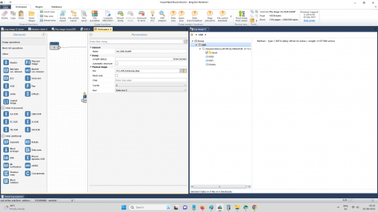

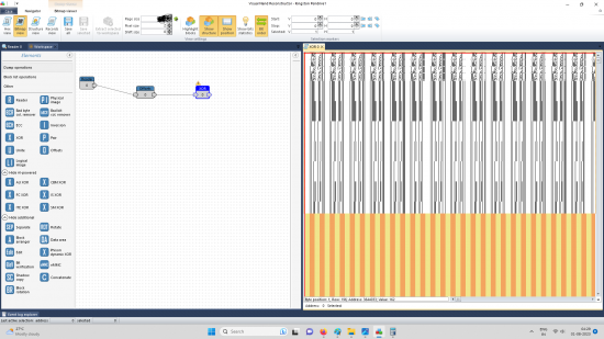

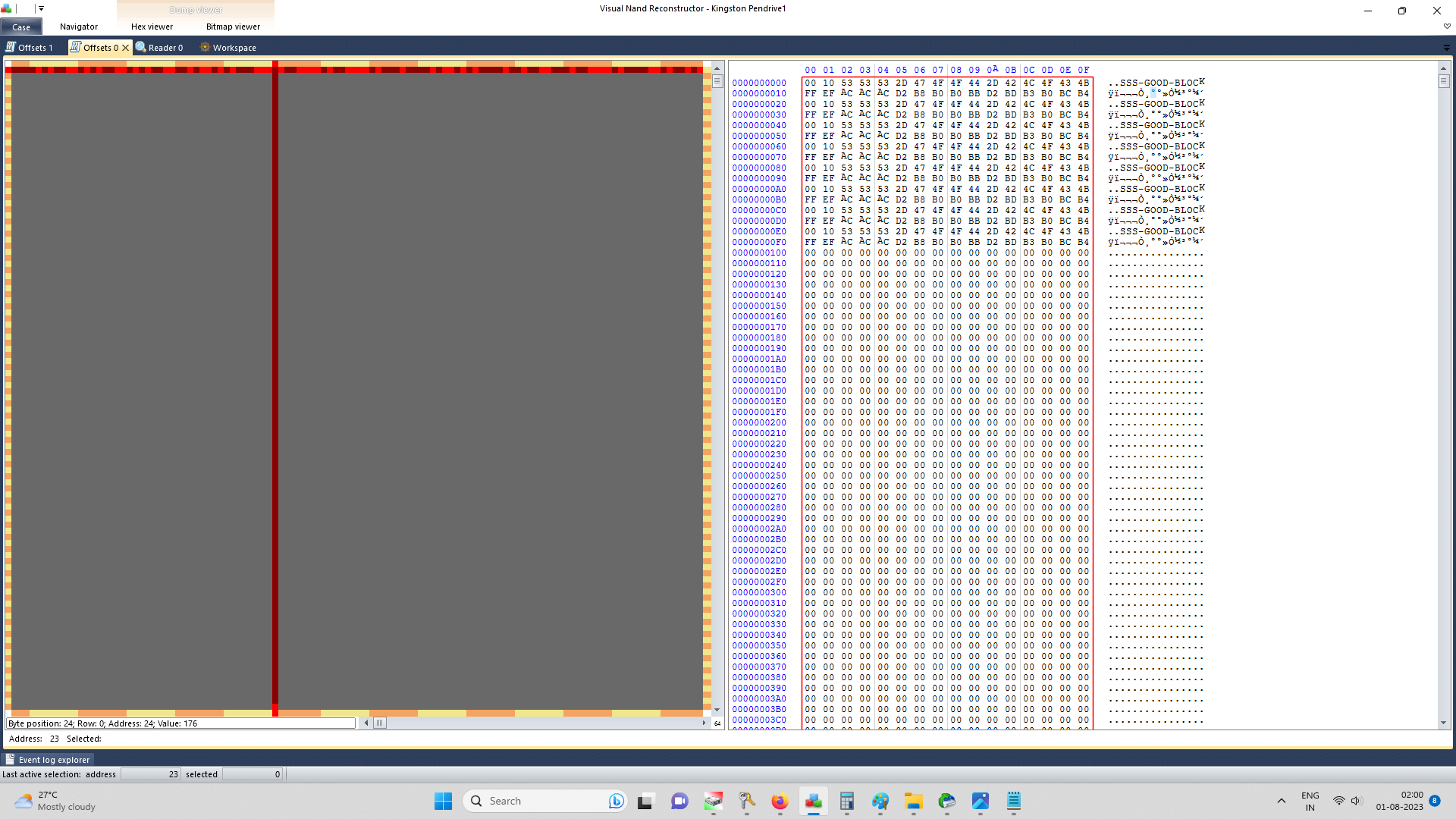

same chip id. Dump from a block . Page 01
File comment: Kingston Data Traveller Exodia
 Post subject: Re: New NAND ID " 983E980376E4081E " With PS2251-19-26 CTRL
PostPosted: July 31st, 2023, 19:02
Posts: 456
Some decryption. Some Tables.
Good Night/Good Morning :)

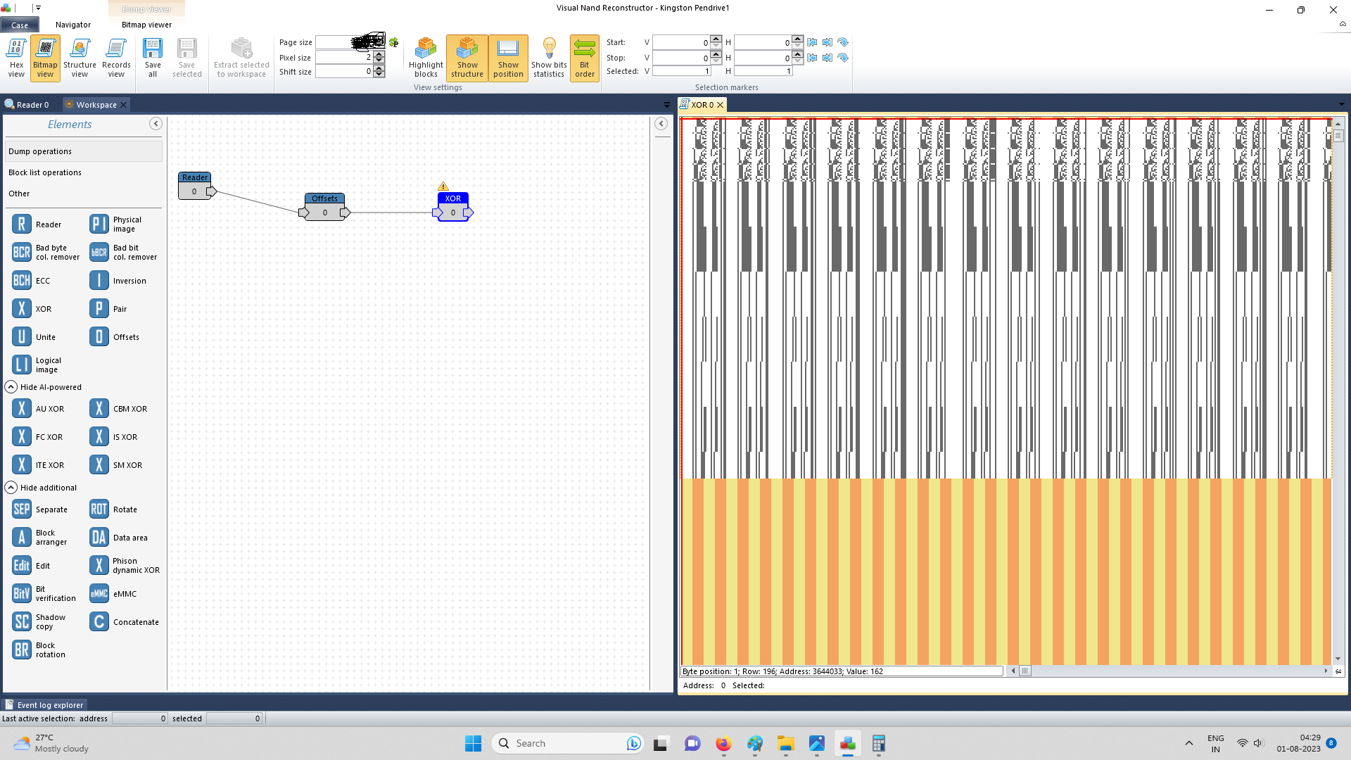

I could dexor my dump with same chip id. The controller is Innostor. I will give a shot with Exodia M series too... :)
PostPosted: August 1st, 2023, 20:17

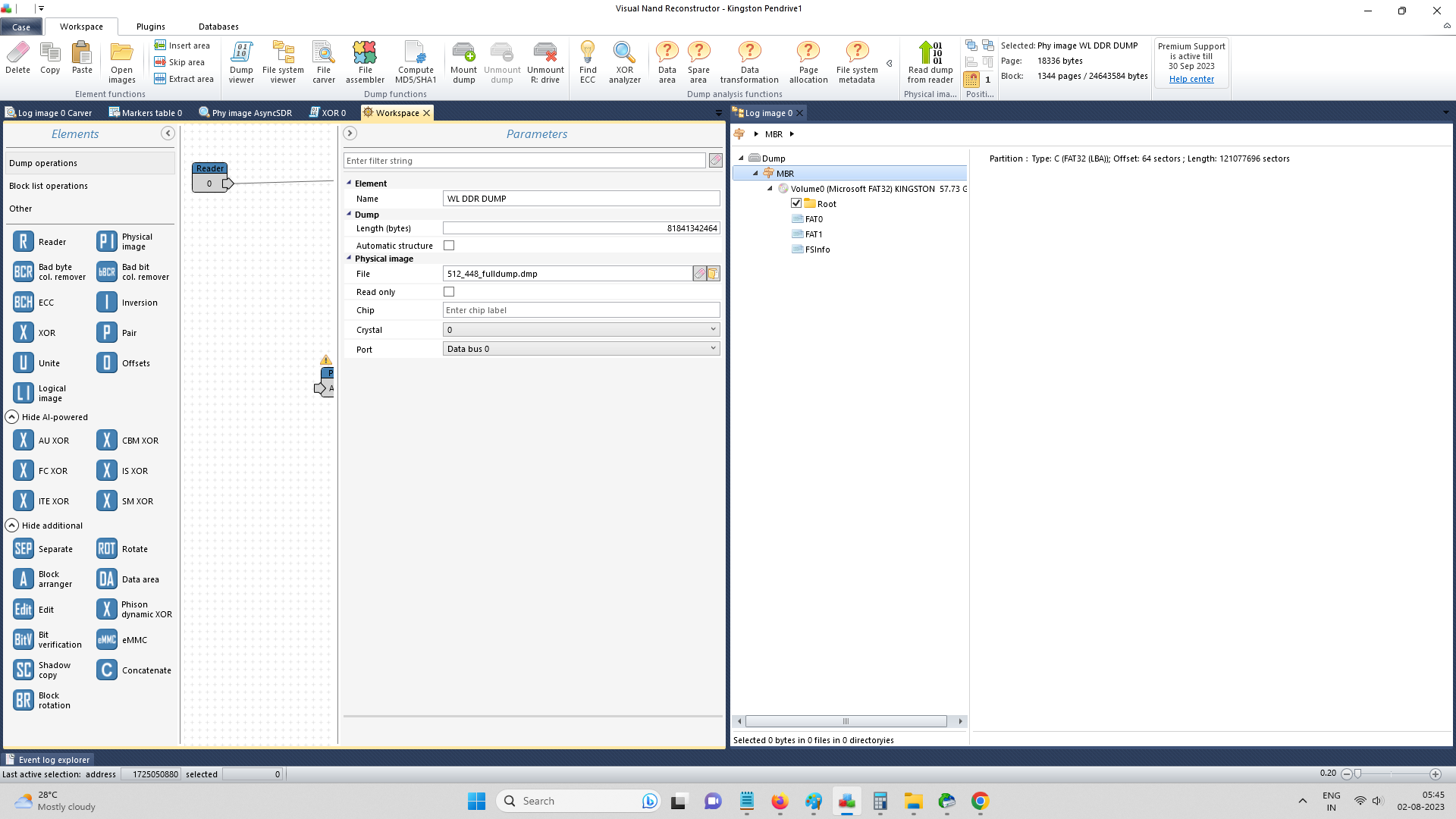

Posts: 456
I think I am getting there :)
Loads to learn and explore. How would one go about "set features" || making custom file for RR || read sensitivity setting in VNR ?

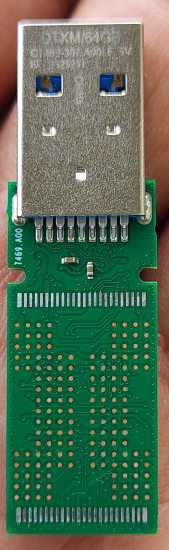

Friends ,
I returned back this case and god is very mercyfull ,He gave me a HP 128GB with same controller + 2 NANDS instead of 1 :mrgreen: ,Same Issue in Reading
