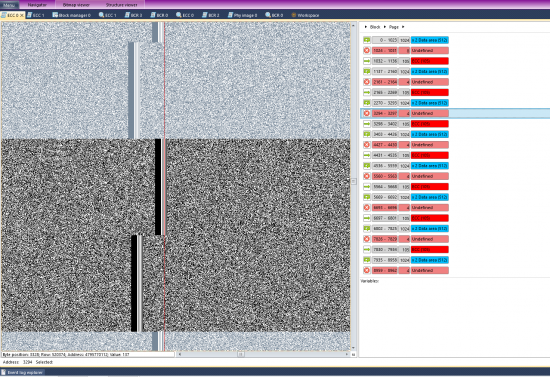

I'm practising some old training material and stumbled upon this one when defining SA. Seems like there is a kind of shift within the blocks and I have no idea how to correct that.
What elements do I use to align the pages in the blocks so I can define SA properly?

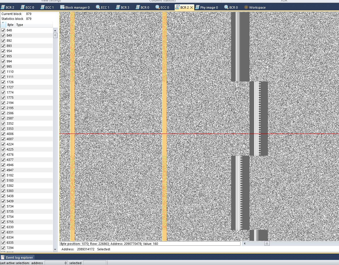

Already did that. Here's how it looks in BCR.
 Post subject: Re: Shifted SA?
PostPosted: November 4th, 2024, 7:27
Posts: 922
Yes, BCR is proper element for it, but you need set correct block size and parts.

I think in the BCR element settings (in workspace click on BCR element --> right panel) you should reduce block size twice.
