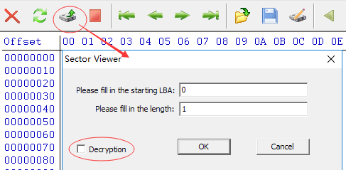

1.In WD utility, choose Tools-> User Sector Viewer to view new sectors, there is a button of Decryption on dialog box. Click this button, a interface of decryption options will pop up. Decryption will take effect when these options are set, then users can see the decrypted data when they view sectors. (shown as pic 1)

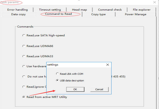

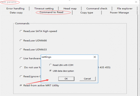

2.In Data Explorer, choose Task params -> Command to Read -> Read from active MRT Utility->USB data decryption, then the data is decrypted when users copy data or open file system.(shown as pic 2)

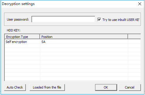

Introduction of USB decryption settings: (shown as pic 3)
The setting is easy. There is a user password box, input password if users have set it. If not, ignore it.
There is a option Try to use inbuilt USER KEY on the right of password box. It is clicked by default. It is better to click if users don’t input password.
There is a HDD KEY list in the interface. EDEK data is stored by system in encypted USB HDD. To decrypt HDD, users need to get EDEK data and combine it with user password so they will get a new KEY to obtain correct data. Click the button Auto Check under the list , EDEK data will be obtained automatically and saved as file. Next time when users want to use it, they can load from the file.
Click OK when all options are set. If click Cancel, settings will be canceled.
