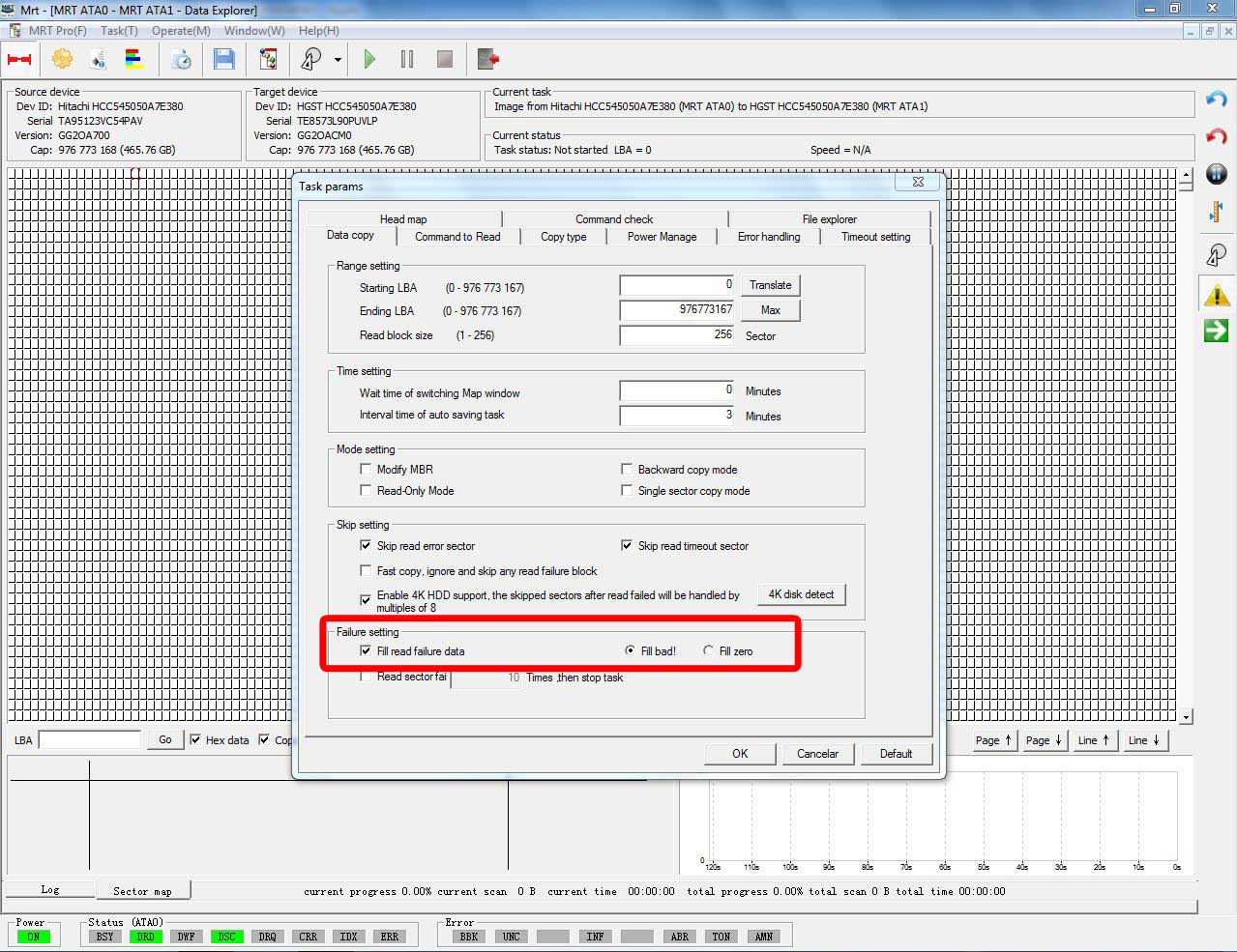

Starting to use my new MRT ultra I noticed that you can not save only working files :shock: (like PC3000 do).
All files (working and broken) will save also.
Support say "auto-identification was considered in our improvement list".
So actually when have a disk with lot of bad sectors result will be lot of broken files mixed with working files. .......that's it.
When client receive recovered files can be a problem because some important file can be broken.
I will ask to other MRT users.....how to deal this problem?

ISTM that the bad sectors should be cloned with a signature, eg "BADBADBAD ...". Then a simple search tool could easily identify the bad files.

It would a lot simpler to determine the bad files by referring to the FAT or to the MFT, etc, assuming the file system is otherwise intact. Anyway, ddrescue can fill bad sectors with user specified signatures.
Are you saying a option like this?

In File Explorer, when you select to save a file, if it has corrupted sectors in the log will appears "File saving Error..." in RED!
You can save the log and filter the files with error ... Piece of cake.
