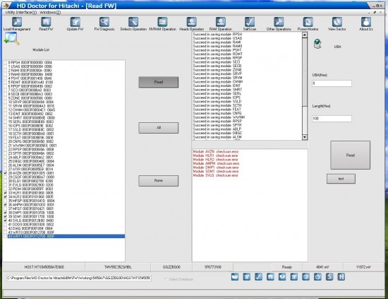

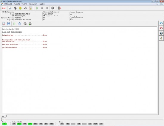

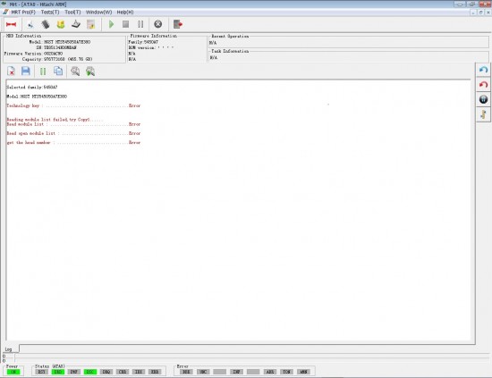

I really did not expect to see old hd doctor support hitachi 5450A7 family but modern mrt professional hd tool not support hitachi 5450A7 family (I tried many models of this family none of them supported by mrt) I checked pc3k and dolphin dfl both support this family so it leaves mrt the only tool probably not supported this.

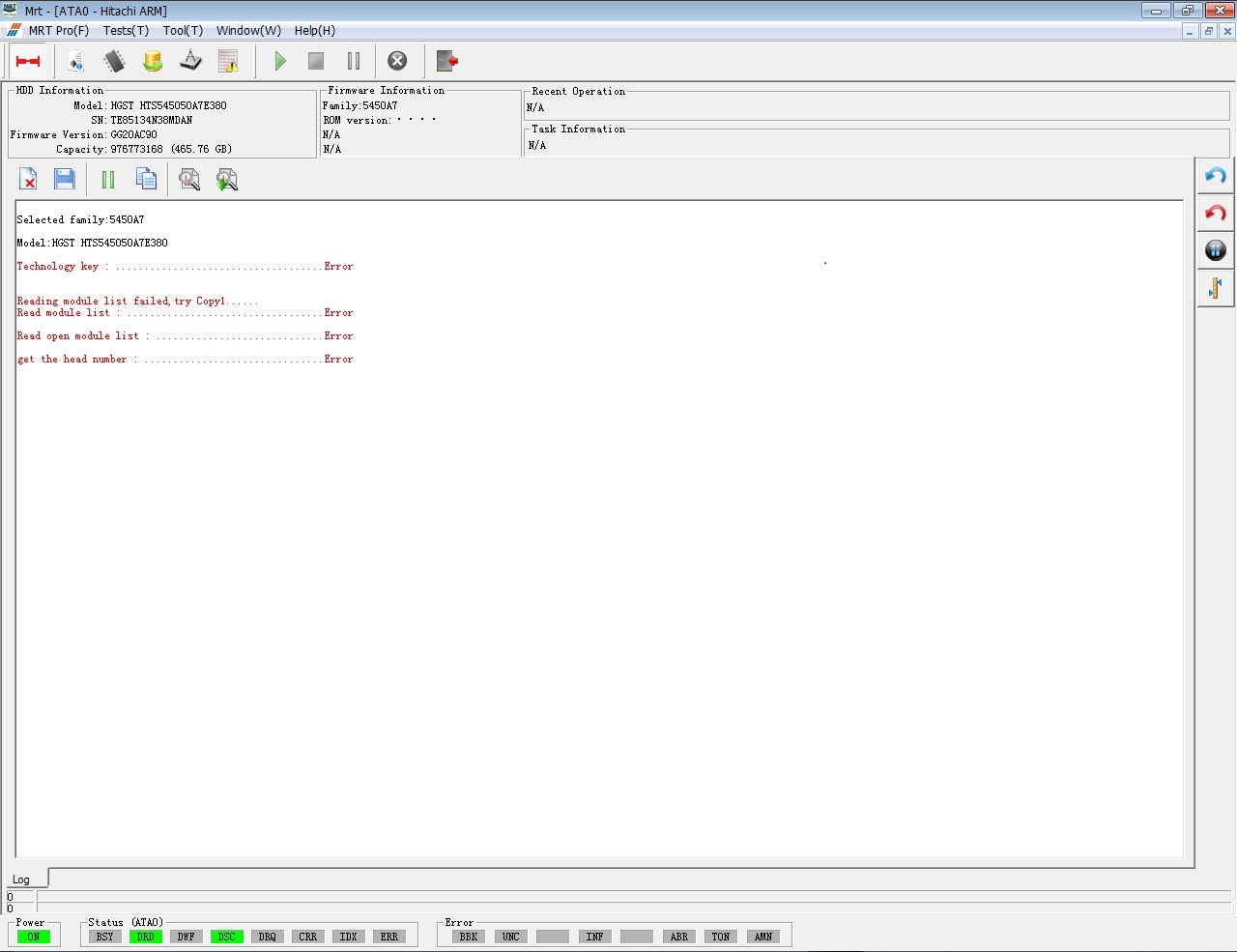

Both E380 and E680 not supported also with the "basic access method" I think all XXXXA7 not supported.

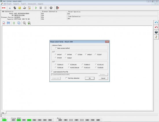

Spildit wrote:
On Select Family : You see correct family in MRT LOG .
I should have mentioned,MRT didn't select the family like he does automatically in A9,I select it manually.

Spildit wrote:
Did you try to put a checkmark on that box - Tech-Key detection ?
Yes I tried,no access to SA as well.

Posts: 1742
Did you try to select 5450A7 with Tech-key detection checked?

Finally with the new version 2.1.2.3 the hitachi arm XXXXA7 supported if we checked Tech-key detection.
Thank you Mrt

I can confirm it worked with a test case friday.
