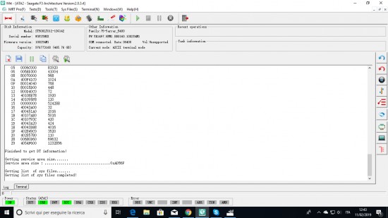

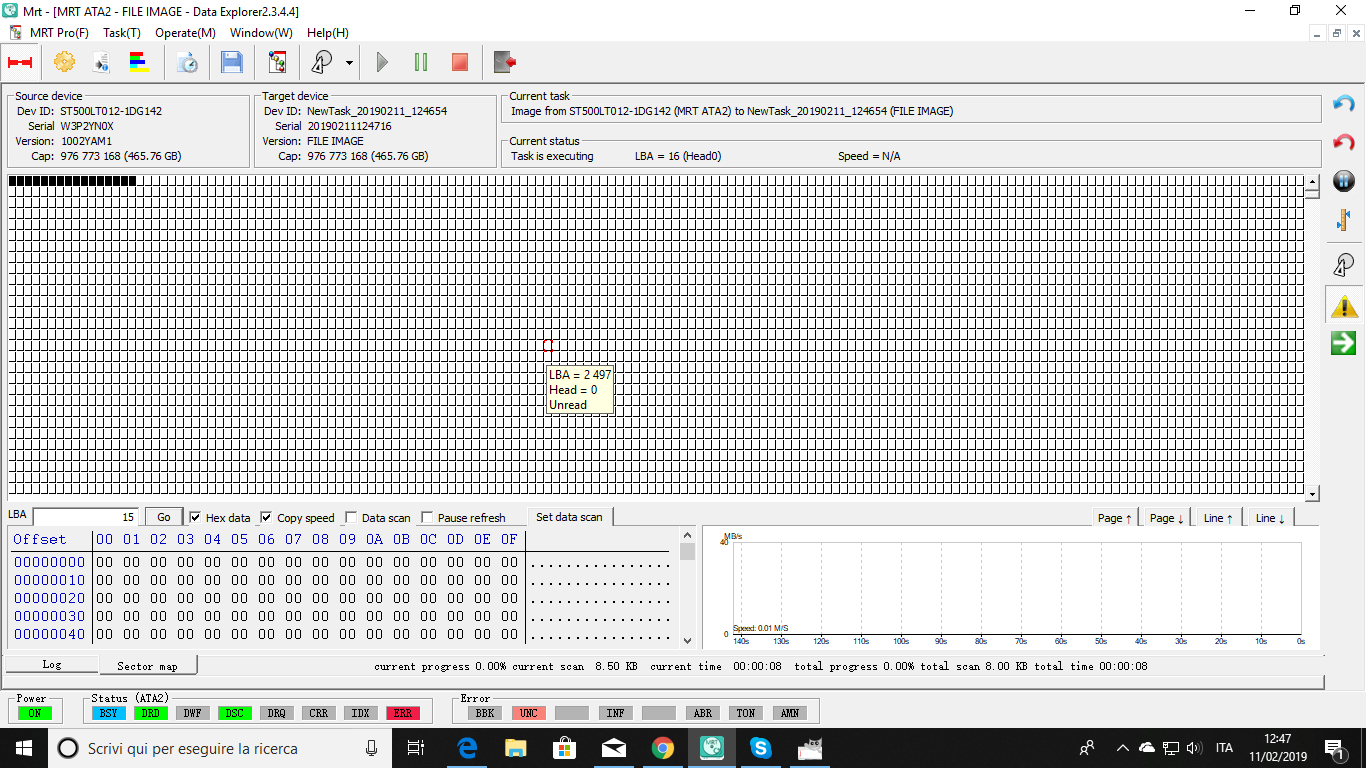

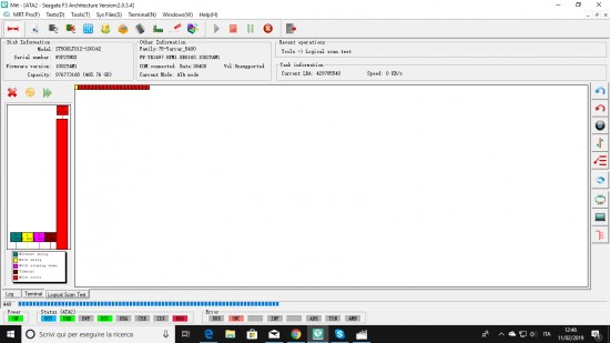

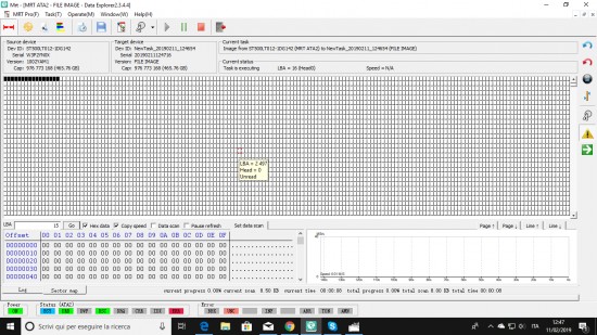

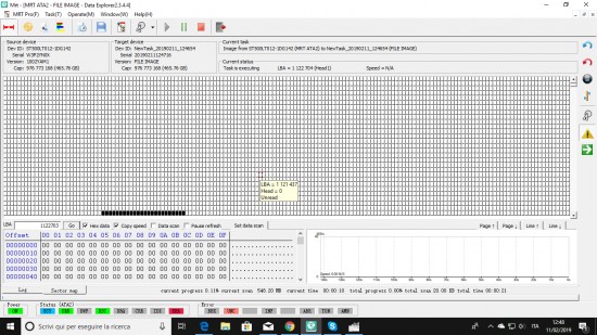

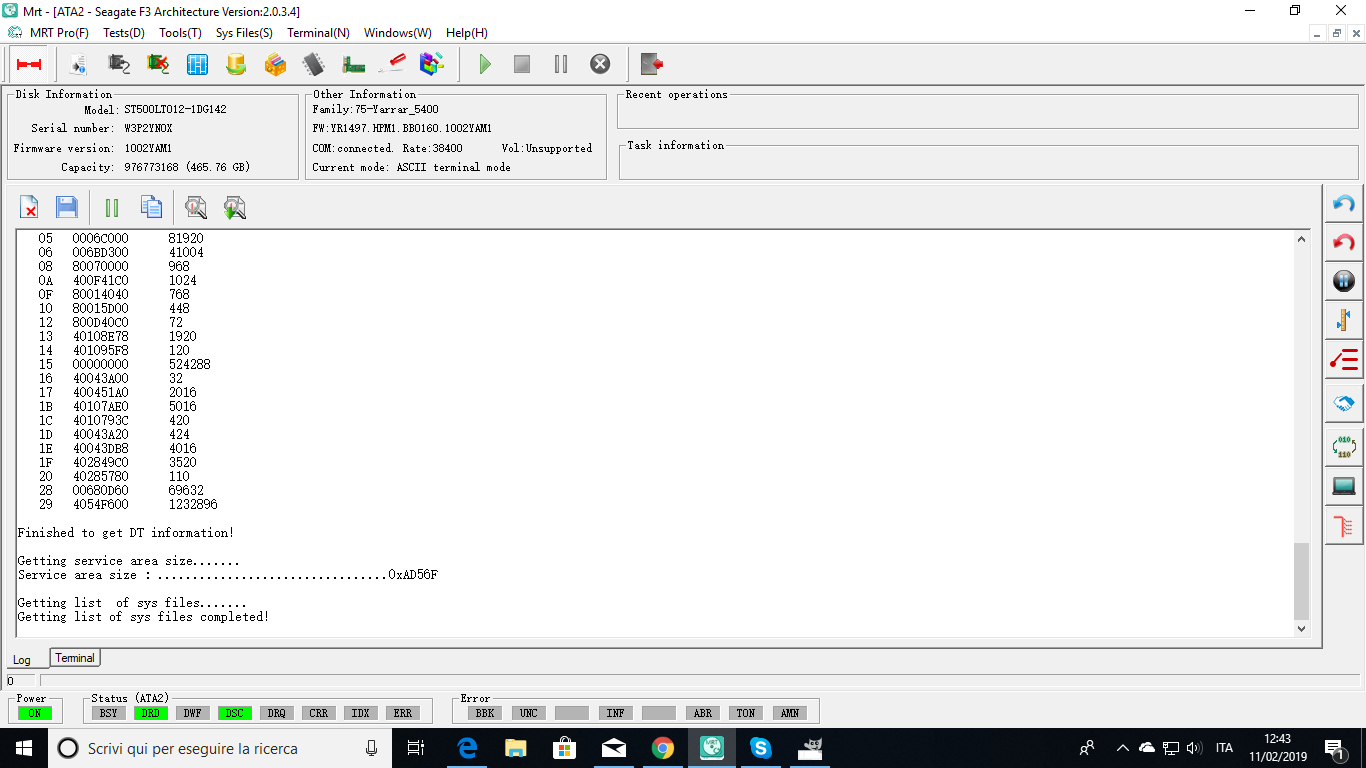

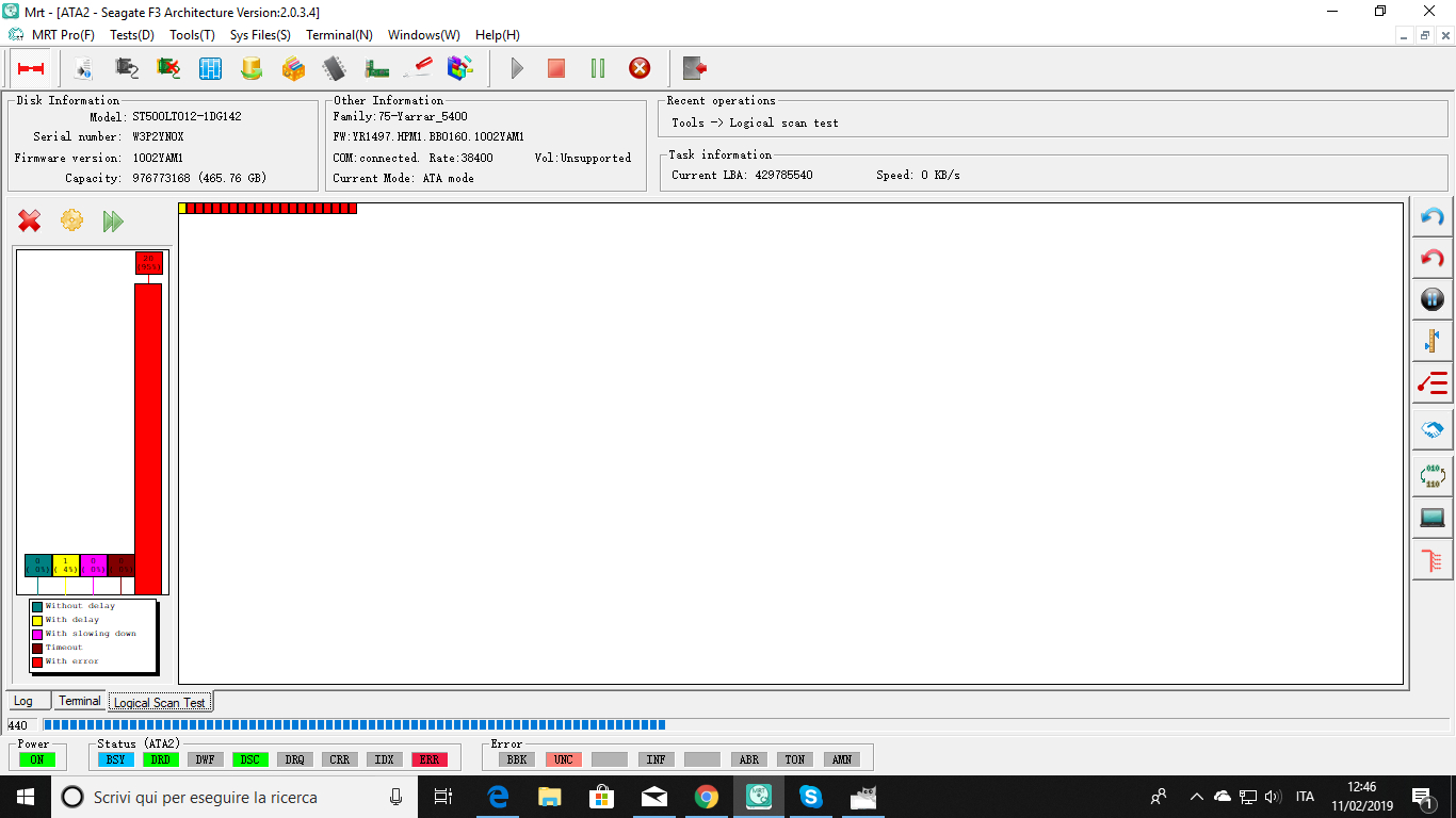

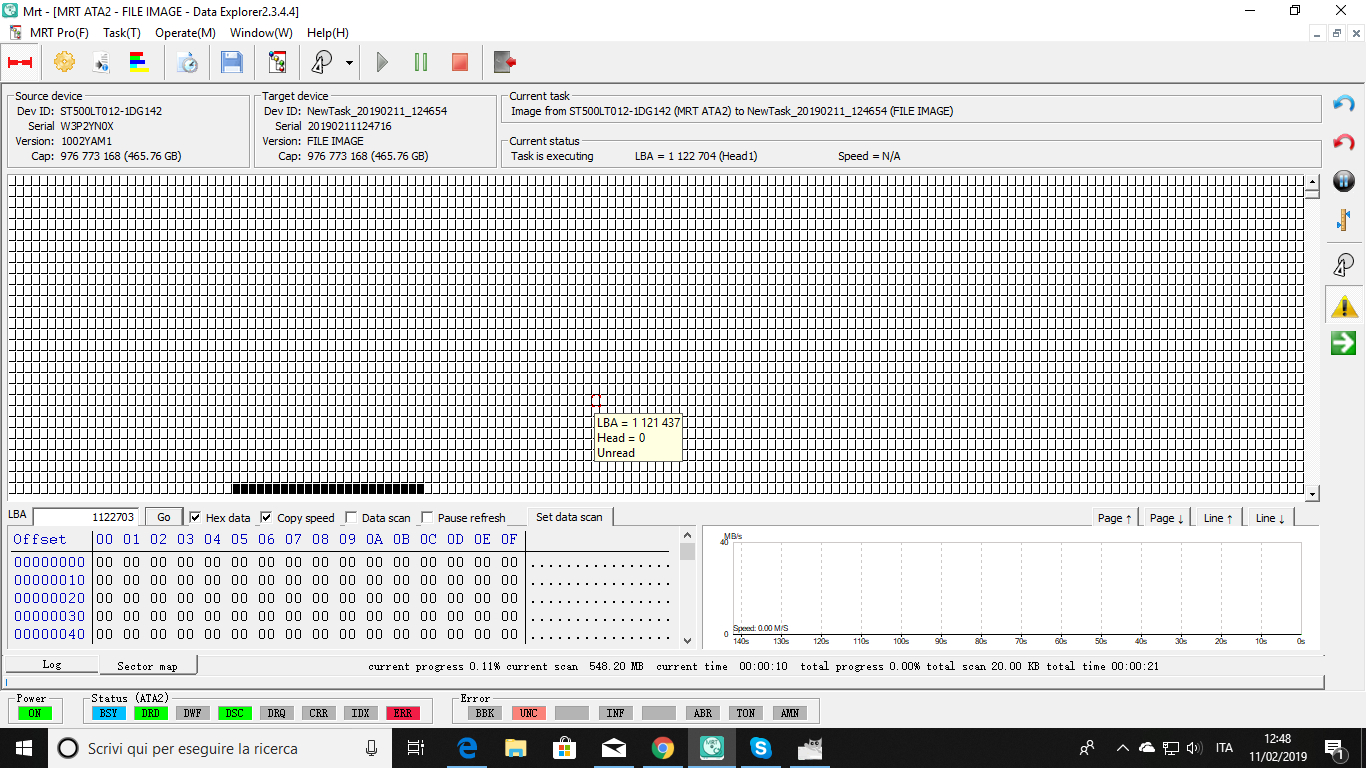

Hi guys, I have this strange situation with this drive. When power it on the disk spin normally and go online, no click. Whit MRT I can see serial number, model, sysfile ext. I have backupped all resourced no problem but whe i try to open partition the disk can't read, When I try to scan surface a see only red sector, When i try to use separate copy I see only black sector with head 0 and 1. Suggestion ? Thanks

What's it showing in the terminal when you first try to read a sector? Also, is it staying BSY after you try reading a sector?
Thanks for reply, this is the terminal log :
F3 T>
Set Transfer Mode selected
Ultra DMA selected
ProcessRWError -Read- at LBA 00000000 Sense Code=40000087

I'm in standby to receive a dono to swap head. I have try more time to clear smart and rebuild translator

I would look first at how many heads the HDD has.
Then make a copy of the system files and if you can read the copy 0 and 1, in principle those heads are fine.
If it does not make you strange noises I would wait before opening the HDD.
If you receive the donor you can try changing the PCB before. It is rare that it is that but it is very easy to do and you discard some other problem.
I suspect that the HDD area is damaged.
It's just an opinion of what I would do. Greetings.

thanks to all for the answers, according to my client this hdd started to become slow, after a few hours he noticed this problem the hdd was virtually unusable. When I was delivered, I backed up the ROM and the firmware without problems, I then opened DE and saw the partitions but when I tried to read the contents the disk was reading error, so slowly even stopped seeing the partition. If it were a damaged area of the disk during the scan I would notice some green, some yellow and some red, here it's all red, it does not read at all. That's why I thought of the heads, but of course it is my hypothesis and for this reason I asked for your help, it seems a strange case.

I have backup again the sysfile when copy some sysfile i see an error, this is the log :
Save to Folder: C:\UserDataFile\Seagate F3 Arch\Yarrar_5400-75\ST500LT012-1DG142-1002YAM1-W3P2YN0X\Data\SysFile\
Sys file volume0, FID:0, Copy:1 : ...................:Err
Sys file volume3, FID:1, Copy:0 : ...................:OK
