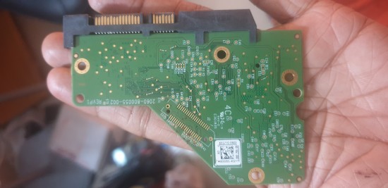

Hi Everyone,
This drive came to me Totally dead. not spinning or no sign of life what so ever,
i have checked the board and found a blown fuse replaced it and results were same.
then used a doner board and it got busted too. after changing the head assembly now drive does spins up fine and gets ready without any clicking noises with doner ROM
but no sign of life with original ROM,
so i tried reading the original rom via programmer and wrote it back to another chip, still same result.
This drive belongs to Apollo Family and can someone please guide me how to generate the ROM and Rom modules from SA ?.
or else if anyone can have a look at my original ROM dump and help me down here im attaching my original ROM Dump
Thanks in advanaced

AFAICT, this looks like a case where the 1.8V ROM has been dumped with a 3.3V tool. The result is that dwords are randomly omitted from the dump.
I would extract the ROYL modules by hand and hope that they have not been corrupted. Otherwise these adaptive modules would need to be repaired.

I suspect that the ROM has been dumped previously, and that the corrupted dump was then written back to a donor PCB.
As for physical damage, I suspect that the original ROM probably survived, although it did not dump correctly.
ISTM that your best plan of action would be to find a donor ROM image from the same firmware version, patch the patient's adaptives into the donor ROM, and then write this patched image back to the patient PCB. That should be an easy thing to do.

Could we see a photo of the original PCB?

there you go

Found a firmware on HDD surgery firmware which is dated as 12/7/18 database and wrote rom and rom modules from that. and now drive works, it is slow, gotta do the slow fix.. now backing up the modules. thanks for your valuable time everyone :)
