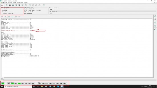

 Post subject: WD500LMVW-11VEDS0 , Zone Allocation table Error
PostPosted: April 9th, 2021, 3:42
Joined: January 20th, 2021, 0:27
Posts: 110
Location: Indonesia
WD500LMVW-11VEDS0 , Zone Allocation table Error , I try to repair module 11 as existing module was Error. But mod 11 write to HDD also error. Possible head NG ? I trt to replaced the head with good donor, problem remain. As on WorkLog file so many modules Error. need your help. thanks.
File comment: Zone allocation table Err

Here is working log :
WD5000LMVW-11VEDS0-01-01A01-WD-WXB1A63f4131
Technology mode key : ..........................: OK
RAM:
Read HDD Info : ................................: OK
Heads number : .................................: 2
Head map : .....................................: 3
SA Cyl Count : .................................: 256
Serials Mark : .................................: 0xFE16
Control version : ..............................: A5C0
Zone allocation table : ........................: Err

load 01...
load 01 to HDD RAM...
The data source : ..............................: file
C:\UserDataFile\WDC Marvell\Hubble LT\WD5000LMVW-11VEDS0-01-01A01-WD-WXB1A63f4131_p.wahyu\Data\Modules_ByID
Get 01 module from HDD : .......................: OK
Load module list : .............................: OK
Load LDR : .....................................: Err
Load 02 module to HDD RAM : ....................: OK
Open SA access ...
Get SA access information : ....................: OK
Check SA access data : .........................: OK
Open SA access : ...............................: OK
Soft reset
Soft reset
Load LDR(0x11), As permanent overlay...
Send Data(0x11) : ..............................: Err(Send Data Fail)
load 01...
The data source : ..............................: HDD
Open SA access ...
 Post subject: Re: WD500LMVW-11VEDS0 , Zone Allocation table Error
PostPosted: April 24th, 2021, 14:59
Posts: 489
Location: Usa
Maybe not original ROM,
Try to load Mod 02 after this
Open SA access ...
sometime it is working. Sometimes you could see 0 capacity.
I have met so many times with this case. I could look at with remote connection if you wish
