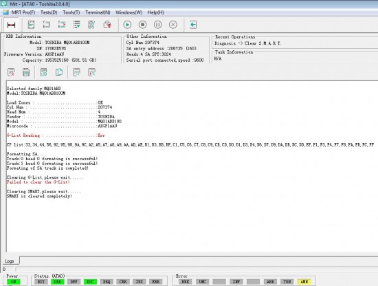

I have an non-detected external harddisk . I have clear SMART, backup ROM. Here is the G list error msg.
Selected family:MQ01ABD
Model:TOSHIBA MQ01ABD100M
Load Zones : .........................:OK
Cyl Num : ............................:207374
Head Num : ...........................:4
Vendor : .............................:TOSHIBA
Model : ..............................:MQ01ABD100
Microcode : ..........................:AXGP1AAU
G-List Reading : .....................:Err
I tried to clear the G List, but failed - power reset, soft reset, hard reset. I have to recover data from it. I m using MRT Ultra.
Please help me.

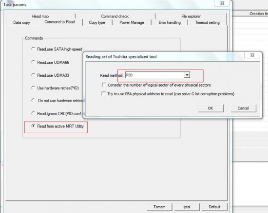

Be carefull when playing with MQ drives at MRT. I had troubles sometimes . Especially new MQ series.
Your drive looking MQ01ABD100M . Problem could be about that.
Try PIO reading at DE

I cannot find PIO in my new MRT Software. I am using version 2.1.6.1
I haven't update yet.
