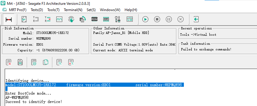

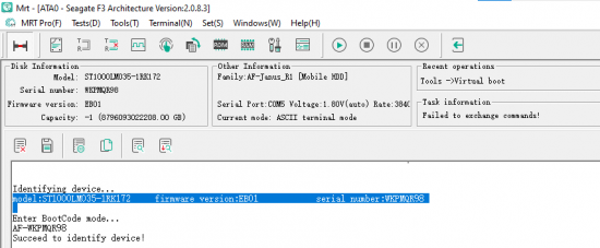

Hello dear
i have this drive after i write virtual start when i turn the power off and on it shows that !
Boot 0x80M
TCC:001F
Disc FW failed to load

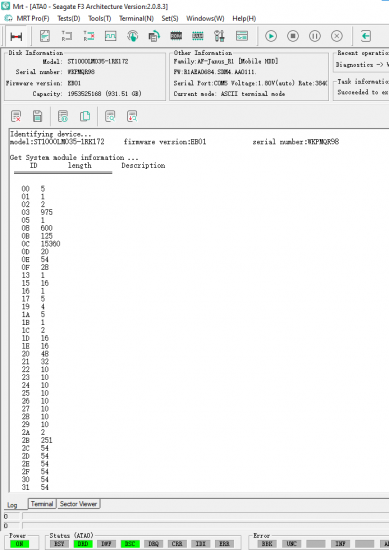

the problem is the rom chip
and with reset smart and m0,2,2,,,,,22
