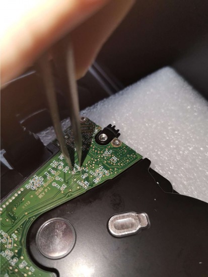

Hi need some help here.
I have this patient drive WD40NMZW-11GX6S1 which I swaped the USB PCB to SATA. After that I tried to load them into MRT utility by shortening TV9 and TV10. I couldn't manage to ID it. It failed and stuck in busy mode. Did I missed anything or is there another way to get this drive to ID in MRT?
Patient USB PCB: 2060-800041-003- Rev P1
SATA PCB: 2060-800022-002 Rev P1

is this unlocked pcb ?
with out unlock pcb you can't access SA.

I don't think this is true. It's Spyglass I.
What is original problem of the drive?
Why you want to short read channel?

sata pcb should work like charm as *northwind* mentioned to.
what the customer told you ?!
Btw it's sed lock drive did you try to block access to sa and make diagnoses ?!

Not true.

Could you explain the unlocked pcb bypass?

No such thing as “unlocked PCB” for Spyglass, it’s just a SATA one from a SATA version. I think mainly they come from WD wireless drives.

Ahhh, my bad. Somehow my brain convinced me this was a Charger.
Guess I'll have to buy 800065. Do you recomend a seller in particular?
November 26th, 2020, 4:16
Donordrives, hddzone... or freelancers like eric lee or sunny. Be careful if you buy from alibaba etc, you can find good prices but you have no guarantee what you'll get. I got two of these Spyglass SATA PCBs and they both arrived dead. I managed to fix one of them but the other was FUBAR.
