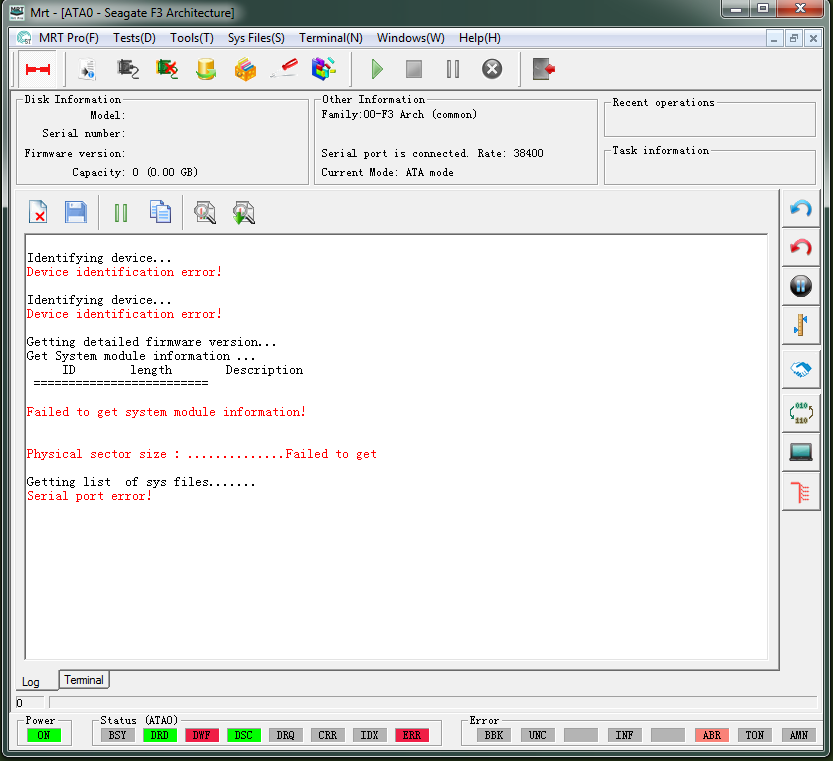

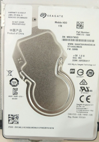

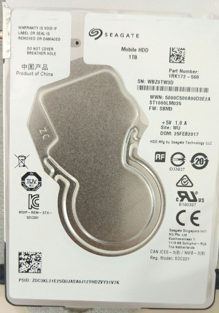

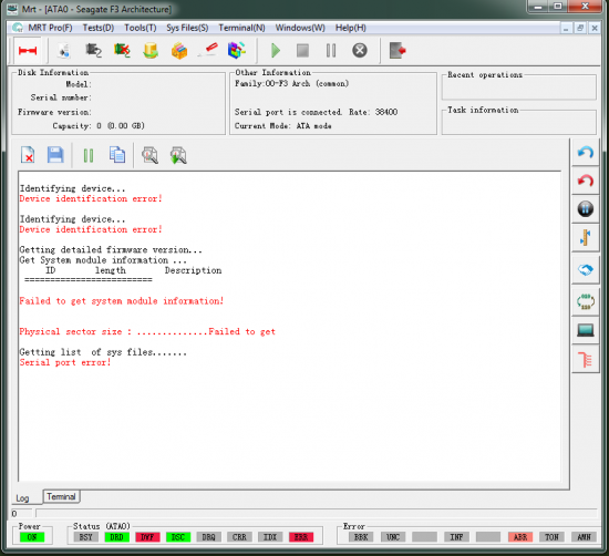

hi guys
i have a problem, hard disk is normaly turn on but not detected, i want to data recovery, my device is MRT ULTRA
Partnumber: 1RK172-568
MODEL: ST1000LM035
FW: SBM3

Usually the terminal log is more useful with Seagate diagnosis. I'm not sure, does MRT actually support this model of drive yet?

MRT Dont support Rosewood yet.....

Family:8C-CheopsAM [Mobile HDD]
Enter BootCamp and Auto identify
