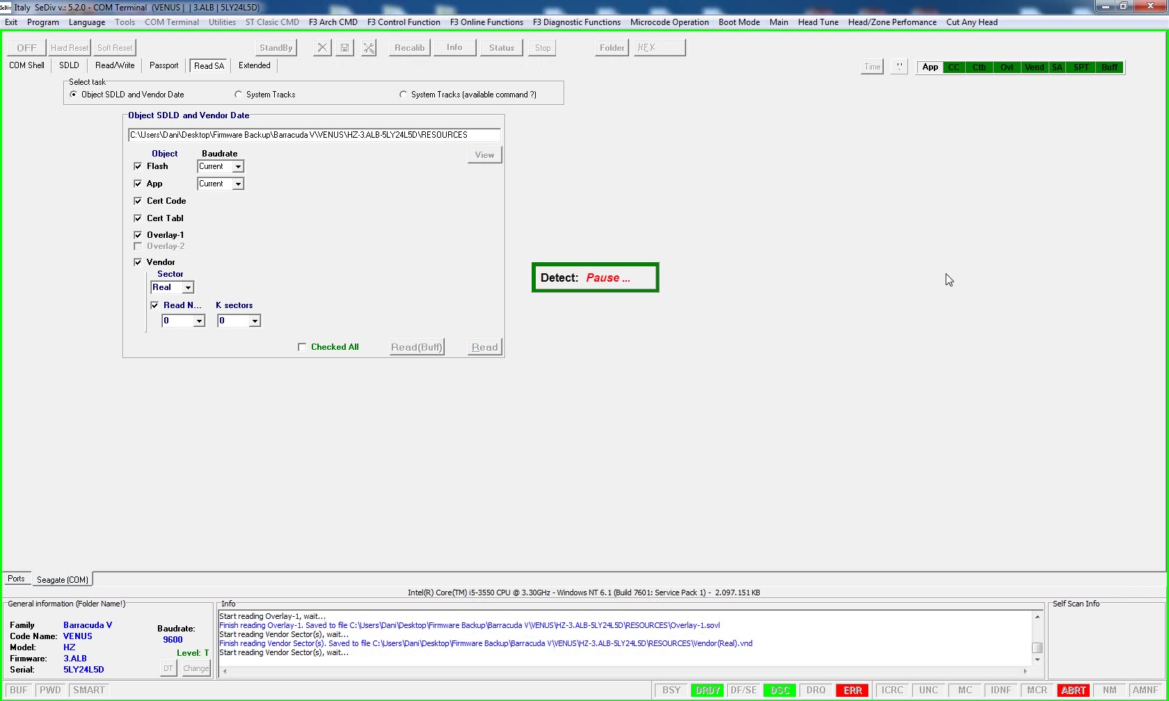

i've found a bug relative to Seagate Momentus 5400.3 (Venus family).
Utility is not able to read ATA overlays and reads ID incorrectly.

Yes i can with Sediv :)
I uploaded a video on youtube so inexpert people will be able to backup fw resource from this type of drives with Sediv ST-10 tool.
https://www.youtube.com/watch?v=dz7NE0kFTmI&t=907s
