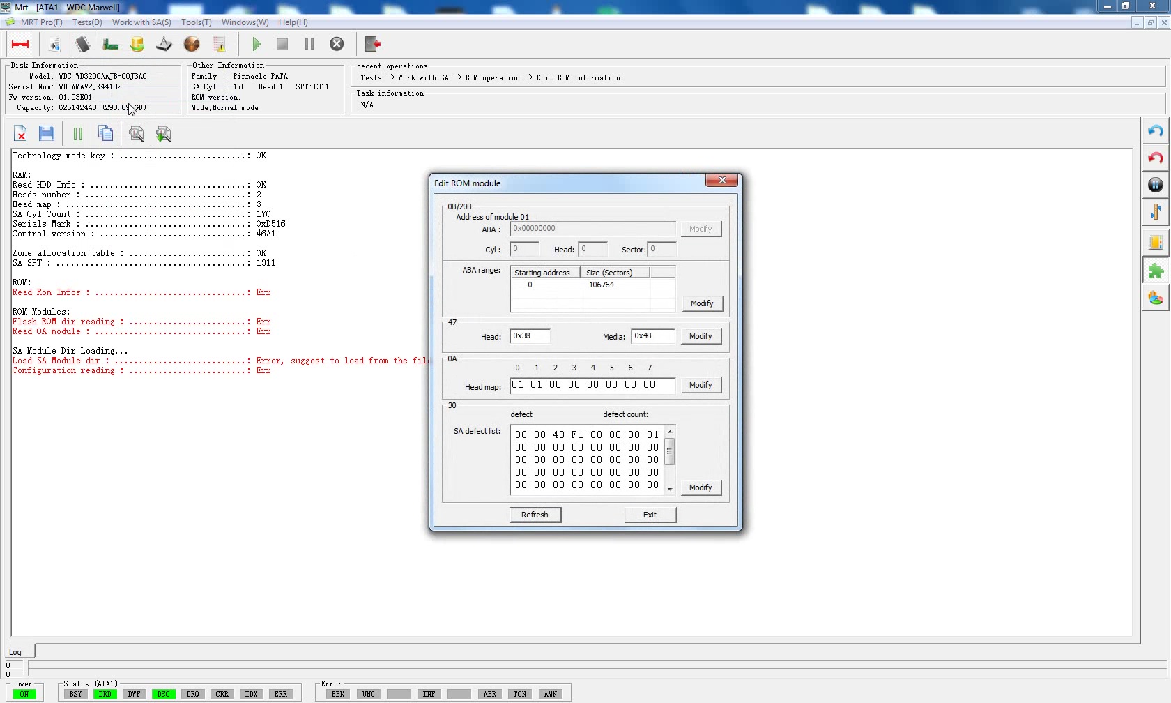

I've found another MRT bug in WD utility, this time related to Pinnacle Pata family.
Utility is not able to read ROM and SA.
https://www.youtube.com/watch?v=1TzDJFuhvXs
Hi, we have checked your problem, it may also caused by the HDD.
From your attached picture, we can't judge what caused the problem.
Please kindly let our technical support remote assistance you to check.
Tehchnical support email and skype: service@mrtlab.com
Whatsup: +8615827155998

Already checked with other tools and they are all able to save ROM and SA (exept for MRT), the hard drive is perfect!
