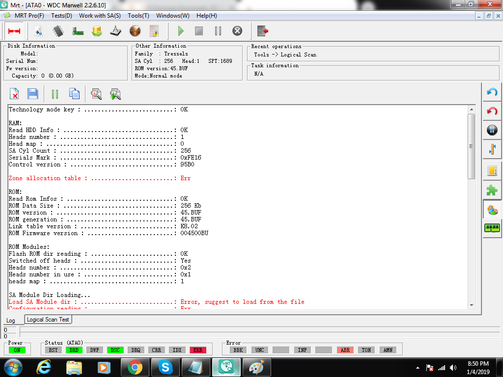

 Post subject: WD5000AZLX-00K4KA0 LDR FILE REQUERED
PostPosted: January 4th, 2019, 11:22
Joined: December 25th, 2018, 3:15
Posts: 11
Location: Varanasi
Technology mode key : ..........................: OK
RAM:
Read HDD Info : ................................: OK
Heads number : .................................: 1
Head map : .....................................: 0
SA Cyl Count : .................................: 256
Serials Mark : .................................: 0xFE16
Control version : ..............................: 95B0
Zone allocation table : ........................: Err
ROM:
Read Rom Infos : ...............................: OK
ROM Data Size : ................................: 256 Kb
ROM version : ..................................: 45.BUF
ROM generation : ...............................: 45.BUF
Link table version : ...........................: K8.02
ROM Firmware version : .........................: 004500BU
ROM Modules:
Flash ROM dir reading : ........................: OK
Switched off heads : ...........................: Yes
Heads number : .................................: 0x2
Heads number in use : ..........................: 0x1
heads map : ....................................: 1
SA Module Dir Loading...
Load SA Module dir : ...........................: Error, suggest to load from the file
Configuration reading : ........................: Err

Is the drive clicking and/or spinning down?

Sping and No Clinking Sound

I suggest you to work with ram operation, load module list from hard drive and use second, most of the time works for me.

Get ROM Data : .................................: OK
Read Ram Data : ................................: Err
Can't make head test!
load 01...
Get 01 module from HDD : .......................: failed
Get module list from HDD : .....................: failed
Solve slow in RAM...
Get 02 module from RAM : .......................: failed

first close systme area in rom
power off , on
open system area in RAM
open system area in Rom
power off , on
with this method I solve 90% of loader problem.
