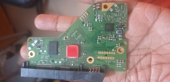

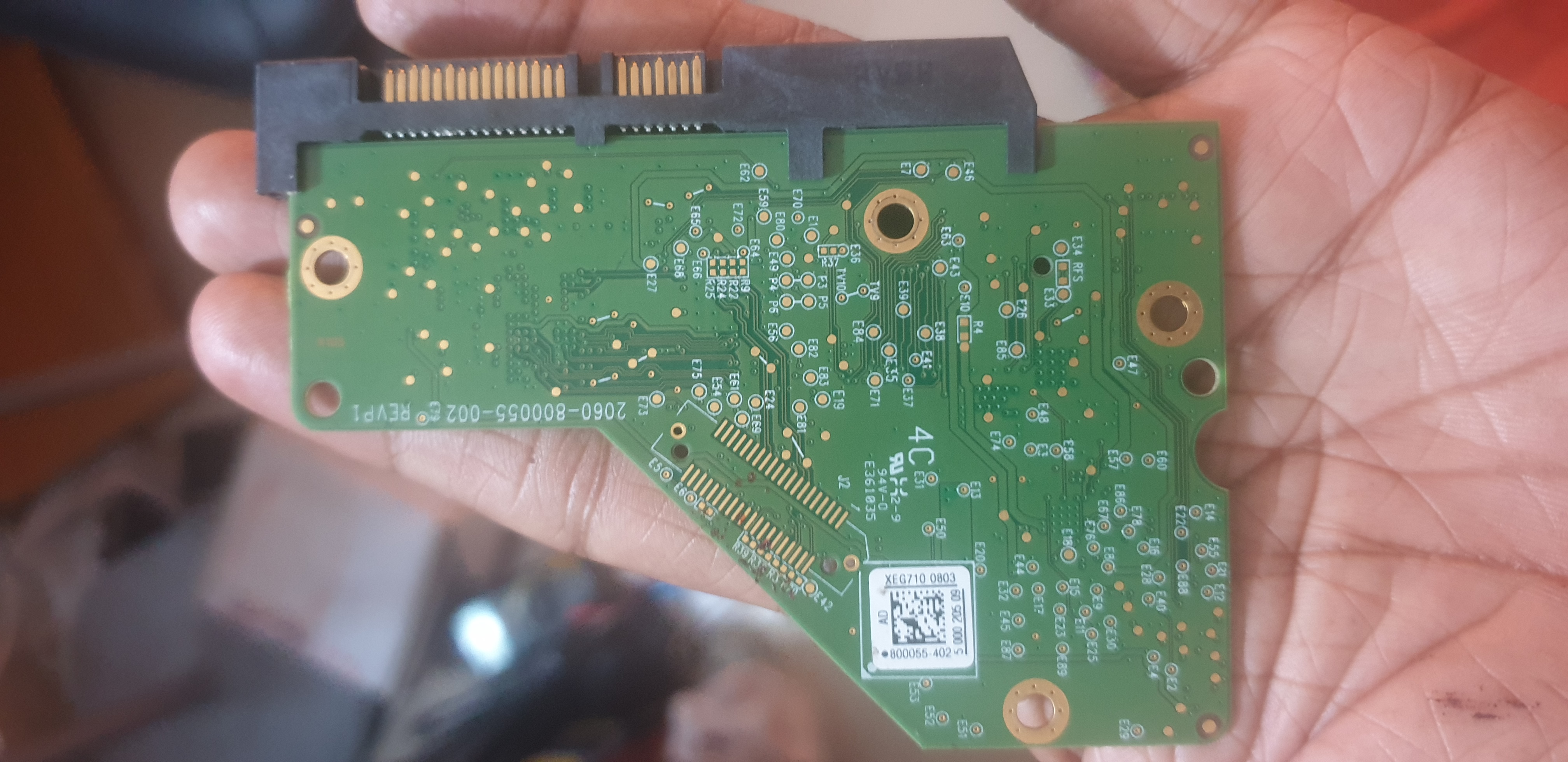

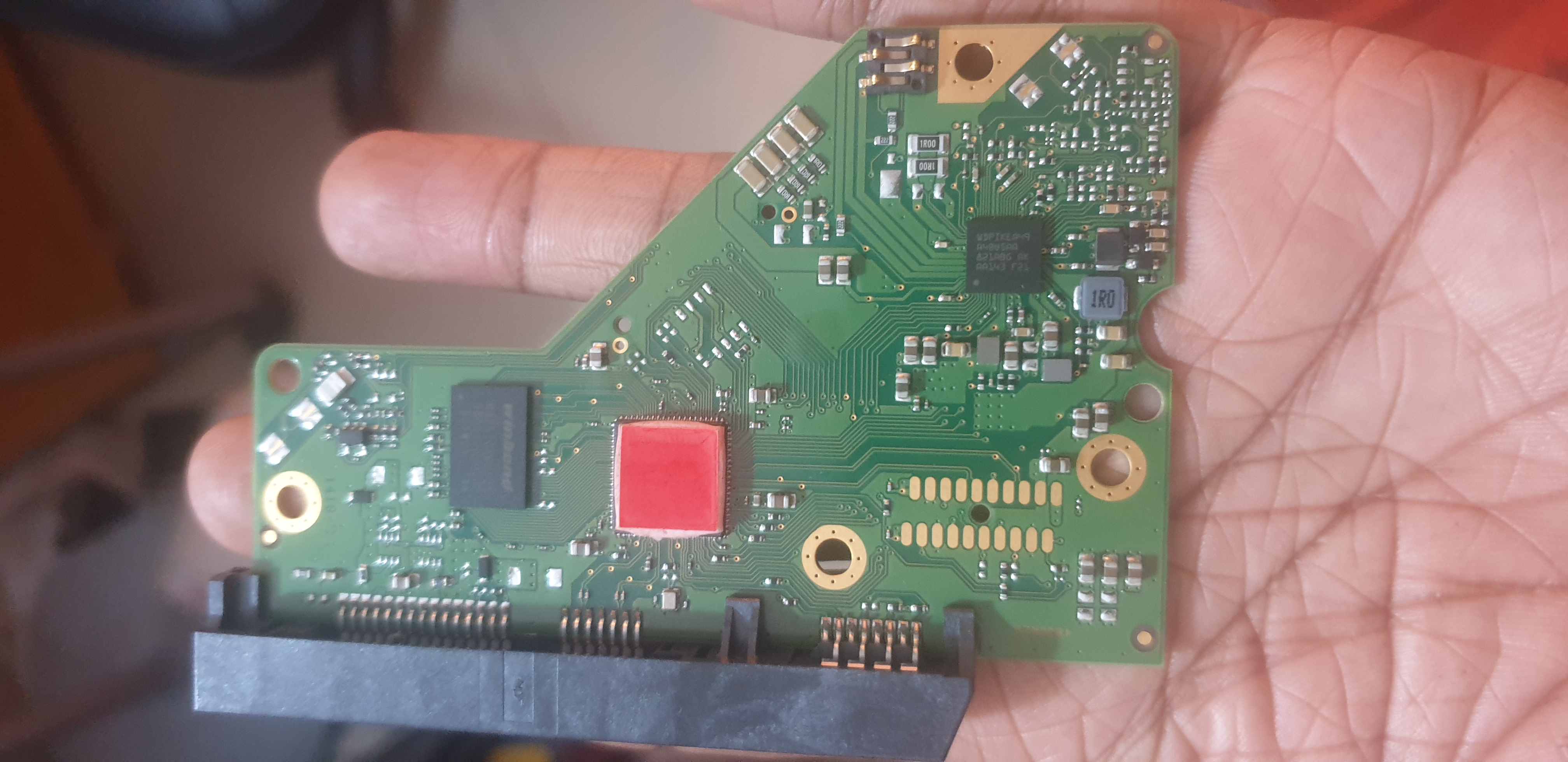

May 17th, 2019, 1:29
Could we see a photo of the original PCB?
Re: WD40PURZ-85TTDY0 Drive with Dead Rom chip
May 17th, 2019, 1:51
there you go
May 17th, 2019, 2:11
Found a firmware on HDD surgery firmware which is dated as 12/7/18 database and wrote rom and rom modules from that. and now drive works, it is slow, gotta do the slow fix.. now backing up the modules. thanks for your valuable time everyone :)
