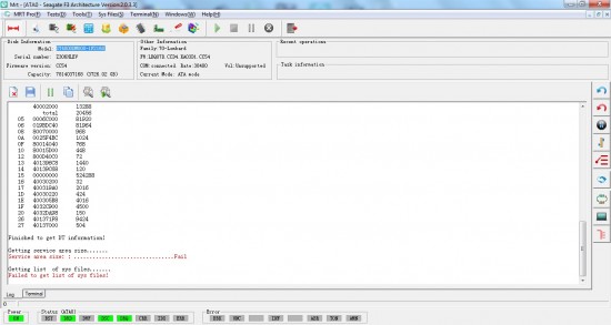

I can't read system files from this hard drive.
drive detect in bios normally and shows files list but can't read anything and write anything
Identifying device...
model:ST4000DM000-1F2168 firmware version:CC54 serial number:Z306HLEV
Device identification error!
Getting detailed firmware version...
LBQ07D.CCD4.KA03D1.CC54
SMP Dbl: 0x3C001000 - 0x0001FFFF
Disk cache reserve size: 0x0
physical sector size of user sector : ..............4096 Bytes
physical sector size of service area : .............512 Bytes
Number of physical heads : .........................8
Get System module information ...
ID length Description
Failed to get system module information!
Getting DT information...
ROM:
ID Offset address Length
00 40030200 40944
01 40030000 512
04 00013C00 7168
40002000 13288
total 20456
05 0006C000 81920
08 80070000 968
0A 0025F4BC 1024
0F 80014040 768
10 80015D00 448
12 800D40C0 72
13 401396C8 1440
14 40139C68 120
15 00000000 524288
1D 40030220 424
1E 400305B8 4016
27 40137000 504
RAM:
ID offset address length
00 40030200 40944
01 40030000 512
02 400303C8 496
04 00013C00 7168
40002000 13288
total 20456
05 0006C000 81920
06 019BDC40 81964
08 80070000 968
0A 0025F4BC 1024
0F 80014040 768
10 80015D00 448
12 800D40C0 72
13 401396C8 1440
14 40139C68 120
15 00000000 524288
16 40030200 32
17 400319A0 2016
1D 40030220 424
1E 400305B8 4016
1F 4032C900 4500
20 4032DA98 150
26 401371F8 9424
27 40137000 504
Finished to get DT information!
Getting service area size.......
Service area size: : ................................Fail
Getting list of sys files.......
Failed to get list of sys files!

High chance the drive's firmware architecture does not support writing sys files.
can't clear G-List
nothing can do in this hdd

Need Unlock ATA.

let me know how to do that in latest release of MRT?
i tried to unlock but no success

MRT utility says above Vol : Unsupported
Try to read sysfiles manually.
