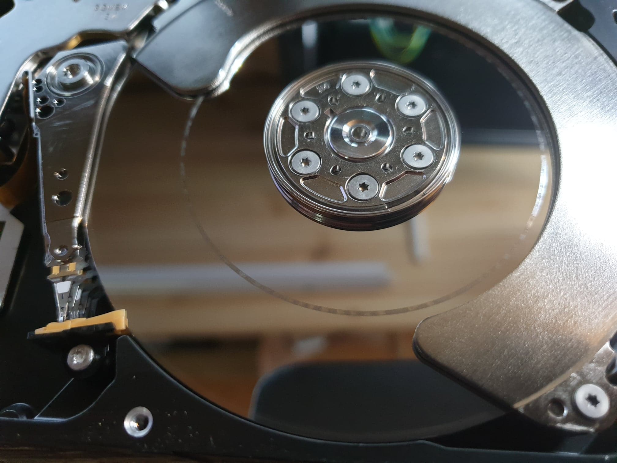

Anything to do here? It spins up, click twice and spins down It gets ID, firmware etc, but says the size is 3,86gb. Is this dead or is there something i can do?

Hi.
I think it is a lost case.
Every time the needles pass through that area I think they will break.
Also if I'm not mistaken, the other surfaces of the HDD have the same scratch.
A greeting.

most likely gone, if customer is willing, partial recovery can be attempted...
Ok, do you know how to partially recover? I have both mrt and pc3k available.

jonbang wrote:
In your case I would remove top head, do the necessary ROM modifications to get the drive to start without h5
Digitalsupport Data Recovery

digisupport wrote:
jonbang wrote:
After checking all heads for debris under the microscope of course! :-)
But in any case, it’s a cleanroom job.

pcimage wrote:
digisupport wrote:
jonbang wrote:
I take so many things for granted, thank you for completing my answer pcimage :)
